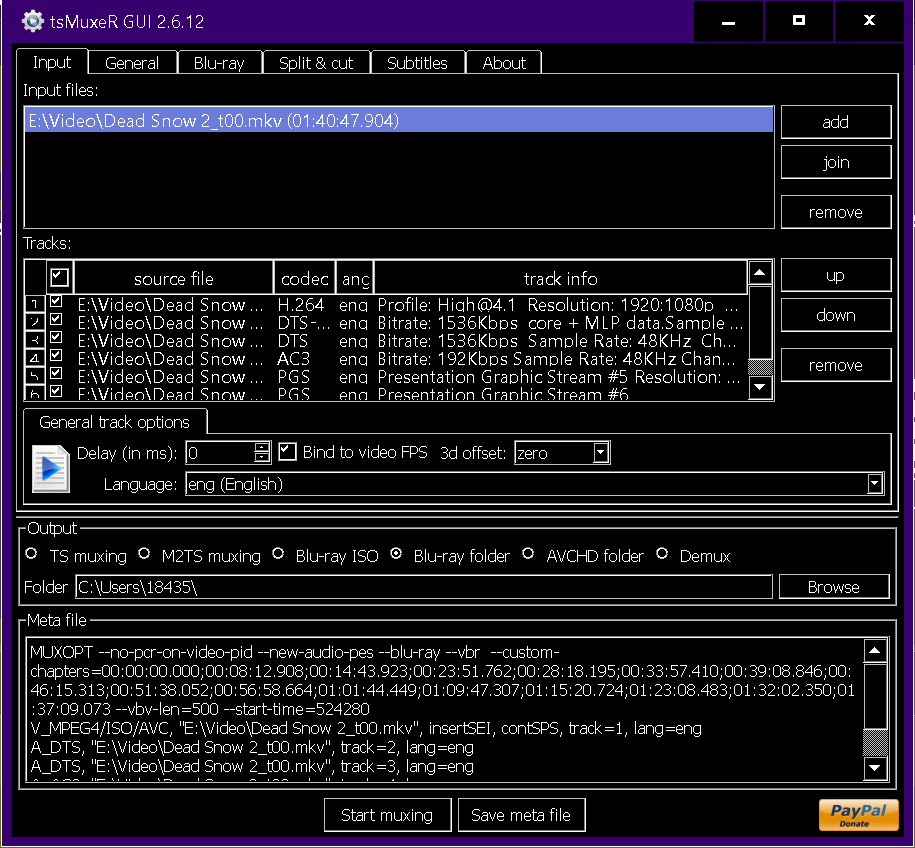

When you open the m2ts in tsmuxer, what languages are shown? IIRC I've seen once that an audio track was flagged as the wrong language.

Thanks for responding. As I mentioned I've been fortunate not to have had any significant issues with this process so I'm not certain how to do what you've mentioned. I have tsMuxeR but I'm not sure where the m2ts you've mentioned is located.

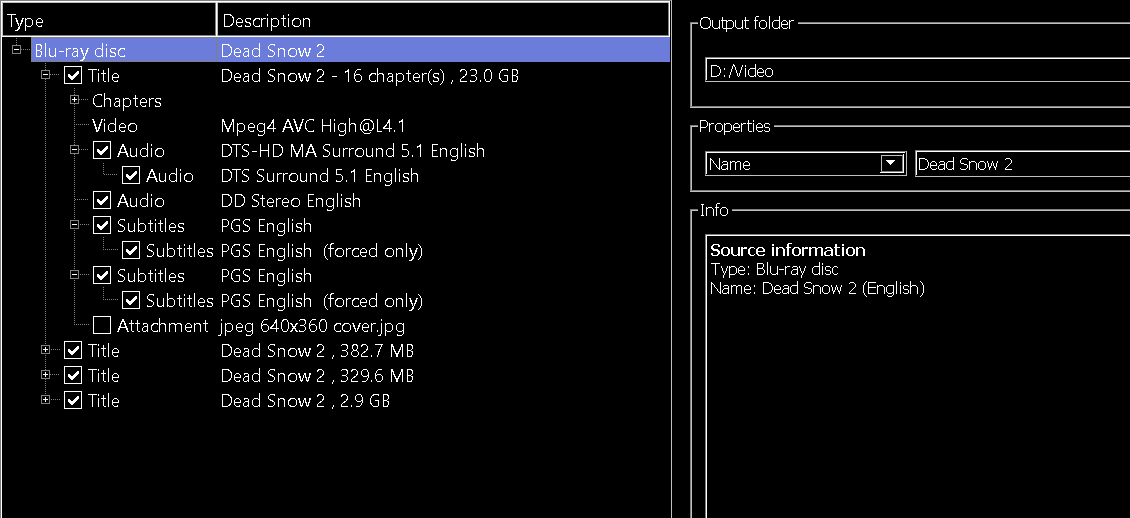

Added this shot of what makeMKV sees FWIW.

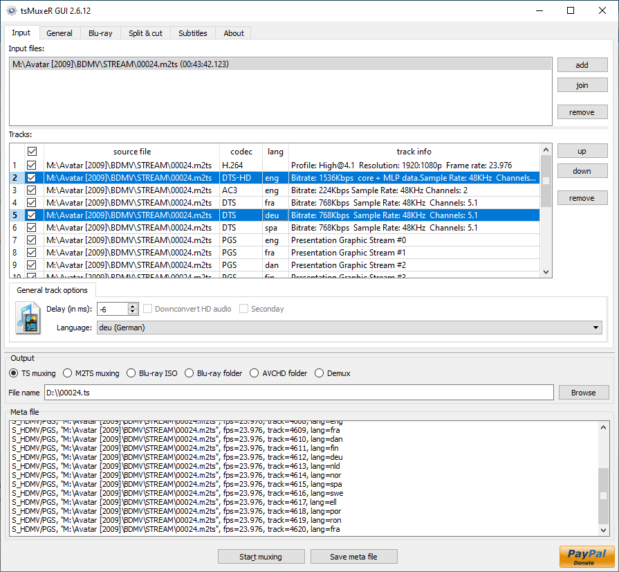

Maldonado wrote: Sun Aug 15, 2021 1:58 pmI have tsMuxeR but I'm not sure where the m2ts you've mentioned is located.
I was referring to you opening the Bluray rather than the MKV to make sure you had not inadvertently stripped any tracks while ripping. Check the BDMV/Stream folder and open the largest m2ts which is usually the main movie. My screenshot of the German Avatar Bluray looks different cause the movie is split over several m2ts (which itself is a container just like mkv). As you can see, it has 5 audio tracks and I usually rip the highest quality in German and English.

Actually, both screenshots show 2 English audio tracks: DTS-HD MA (incl. core) + DD.

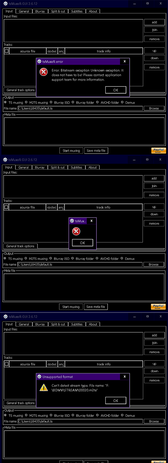

Well, the mystery continues. I have tried to open all 15 m2ts on this disk without success. I don't think it's a problem with the disk as it behaves as expected in makeMKV, it opens and plays in the software player and can be opened in file explorer. Not sure what's up with this.

Yeah, I forgot to mention that the BD might need to be ripped (to ISO) first cause when you open files from the disc, tsmuxer cannot bypass the copy protection as BD player software can.

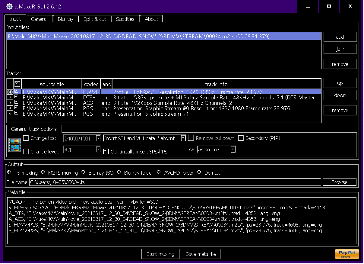

Got it worked out. Now to figure out what I'm seeing...
Got it!
Got it!
Chetwood
Posts: 999
Re: I'm Stumped - Language Issue
Post by Chetwood »
Well, it looks like there's only 2 audio tracks both of which are flagged as English. This appears to differ from the Region B (= Europe) BD I see on Amazon.de which lists German, English and "undefined" (most likely Norwegian). But like I said in another thread, it's possible the authoring is messed up and one of the tracks actually IS in Norwegian despite being named "English". You're sure there's not two cuts on it? The fact that the m2ts you opened is only 8 minutes suggests some branching is going on. And e.g. this page reads: Note: Norwegian and French on International Cut Only.
