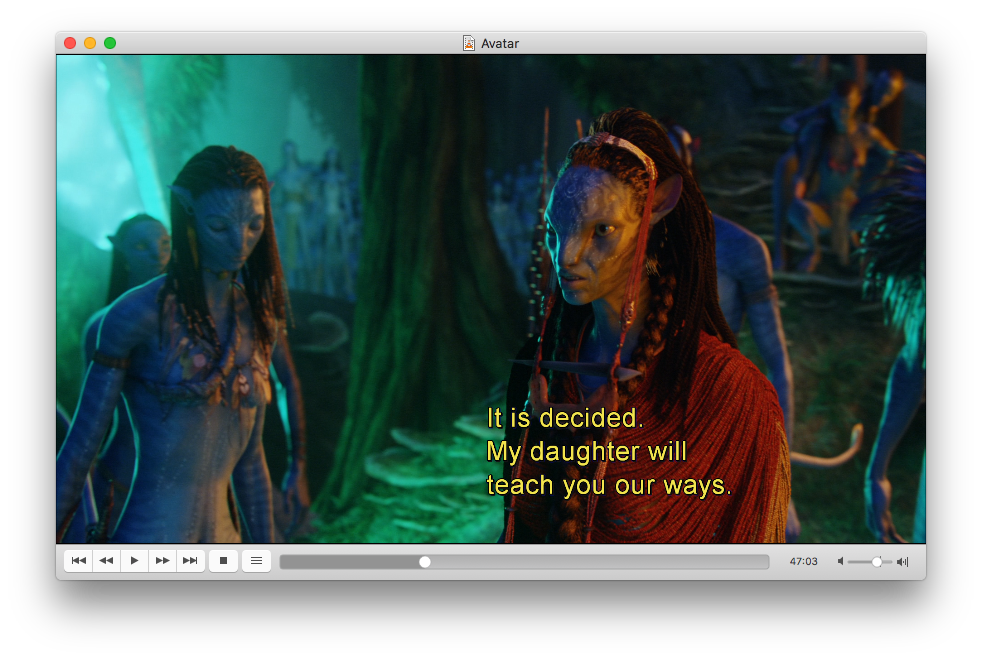

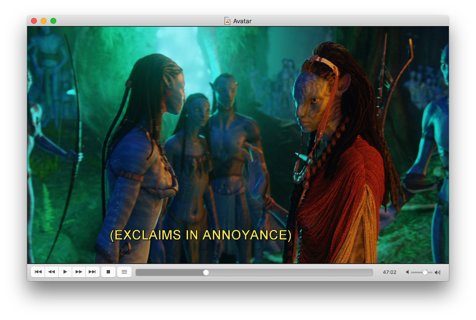

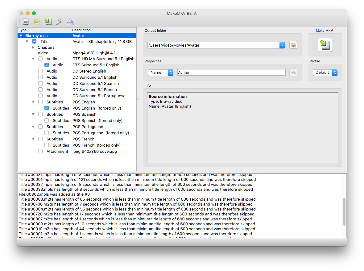

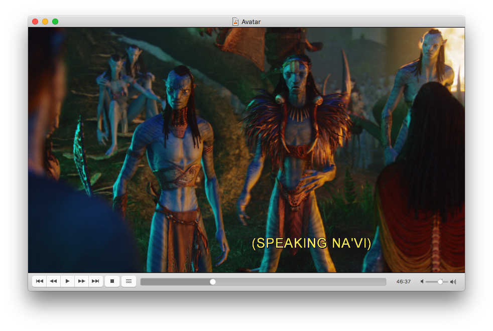

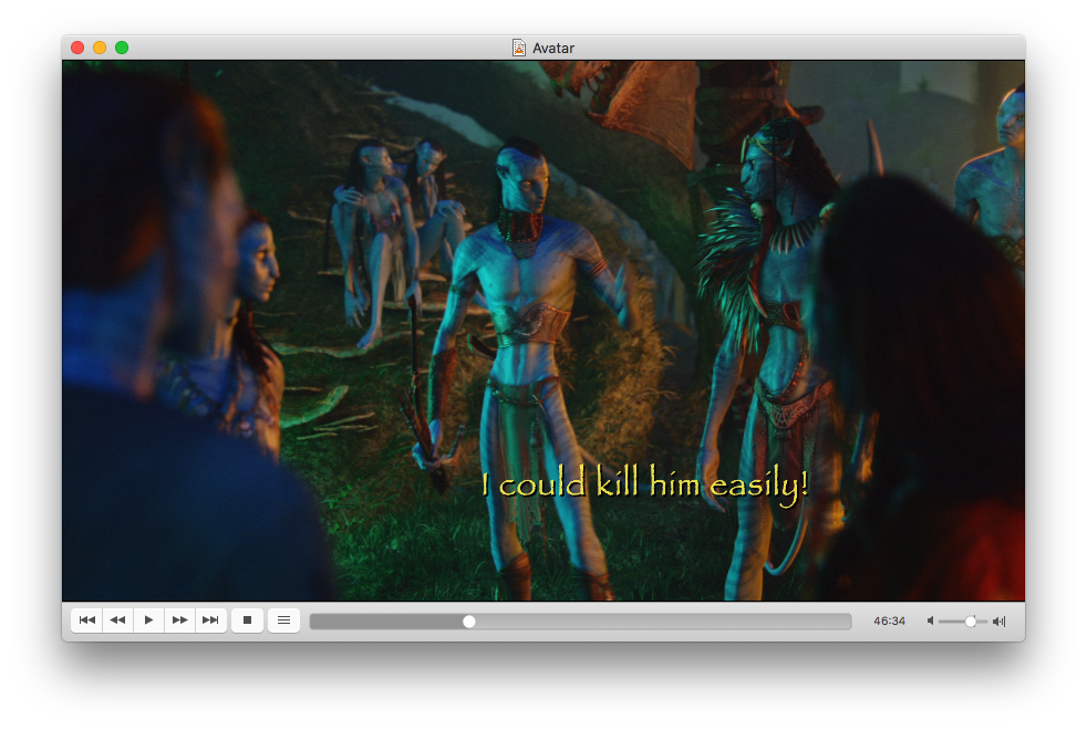

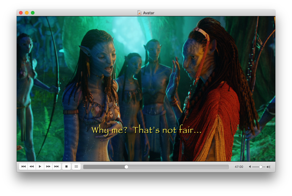

I have attached a screenshot of the MakeMKV ripping options. As you can see, for English there are only 2 options - the first yields English subtitles for every spoken word, the second yields only forced subtitles (that also has the issues I described). I have also attached screenshots (with timestamps shown) of VLC version 3.0.8 playing the ripped movie. For the most part the subtitles are all good, but there are a couple problematic areas as indicated in the screenshots. Those problems include a description of what's happening (shown in parentheses) and also a change of subtitle font and position.

OK - I'm having issues posting the screenshots. Tryng this in two parts...
- Avatar 47.00 Good.png (871.15 KiB) Viewed 29567 times
- Avatar 46.37 Bad.png (874.7 KiB) Viewed 29567 times
- Avatar 46.34 Good.png (858.6 KiB) Viewed 29567 times
Re: Botched subtitles when ripping Avatar
Second part...
- Avatar 47.03 Bad.png (850.43 KiB) Viewed 29567 times
- Avatar 47.02 Bad.png (852.94 KiB) Viewed 29567 times

Here are the options I see when ripping Avatar
- MakeMKV Avatar Options.png (246.22 KiB) Viewed 29567 times
