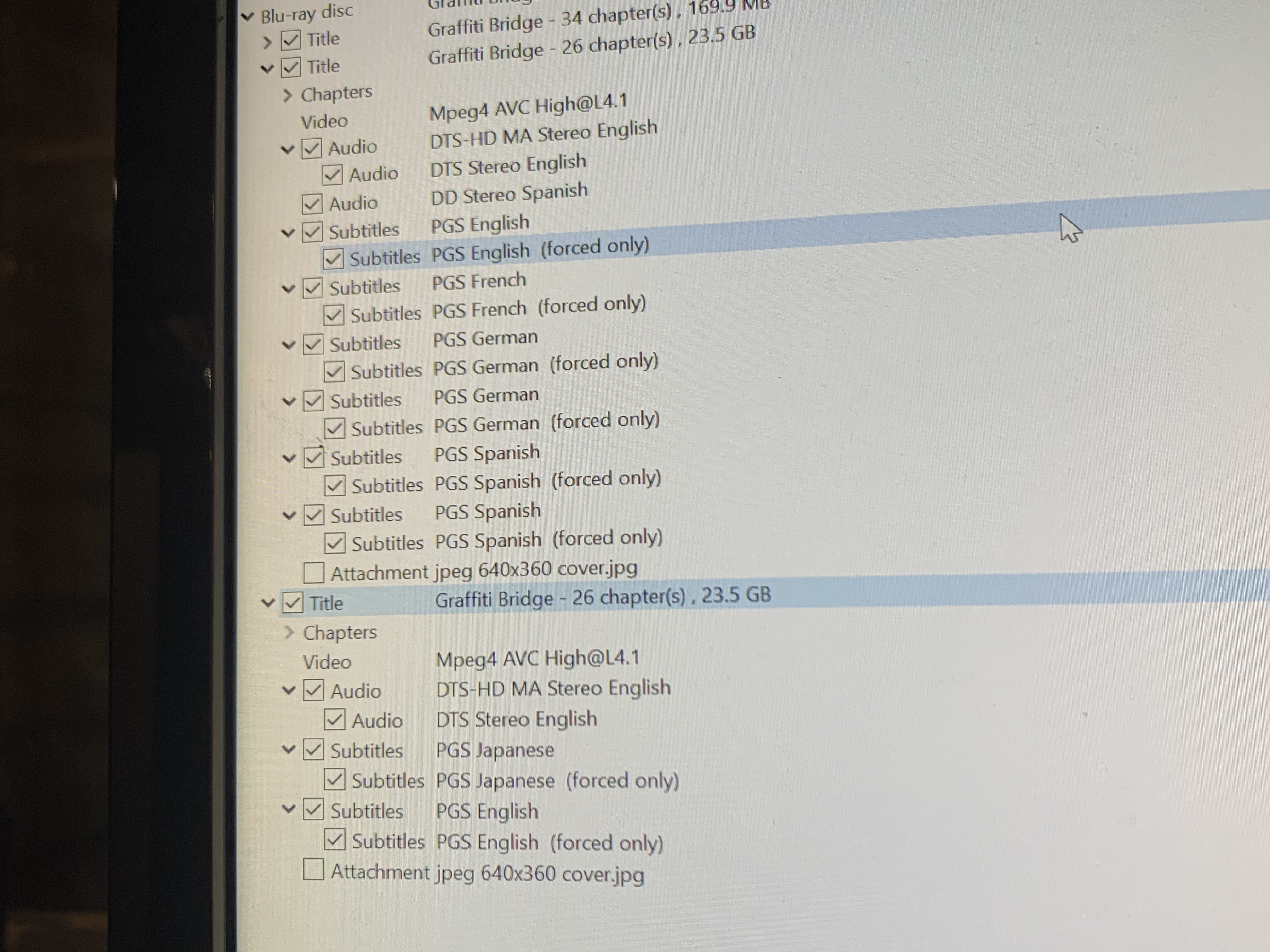

I've ripped two movies (Purple rain and Graffiti Bridge) that both contain 5.1 audio tracks. However, when I load the disc, MakeMKV only sees the stereo tracks. Is there some type of setup I'm missing?
Only getting stero audio from Blu-ray rips

When you click on the little triangle next to the title in the left menu, does the expanded list show one audio track, or multiple?
Re: Only getting stero audio from Blu-ray rips
Thanks for replying. The only tracks that show up in the list are all 2 channel ones. Example, DTS Stereo English is an option. No 5.1 or anything in the list.

I see what’s going on. g Bridge is only 2.0. False alarm!

OK. I was wondering if maybe MakeMKV was choosing the "Descriptive Audio" track, which is usually stereo-only.
I've seen BDs for older movies where the main audio was in glorious, High Definition, remastered MONO, and all the other audio tracks had more channels.
