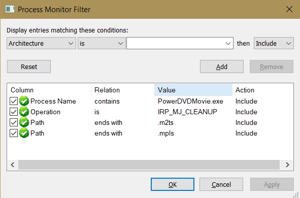

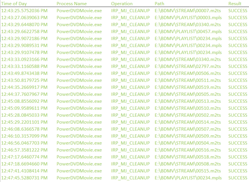

OK, things I learned through this process:
PowerDVD said my display driver wasn't compatible with Blu-Rays...
1) Don't believe windows when it says you have the latest graphics driver installed (OK, I knew that already)
2) Don't believe Intel when they say you have the latest graphics driver installed (I expected better)
3) Don't believe HP when they say you have the latest graphics driver installed. (C'mon, you made this thing)
4) If you find the latest driver, PowerDVD will play Blu-Rays (on my computer)
5) If you're using the latest version of procmon, the filter you want to use looks like this...
Poker354 wrote:This solution above.
I added the "path ends with .mlps" at the suggestion of another contributor.
The result was
Just like a few contributors posted.
Basically matching this MakeMKV

6:34:19.9765545 PM PowerDVDMovie.exe 6624 CloseFile G:\BDMV\STREAM\02797.m2ts SUCCESS
6:34:25.3467140 PM PowerDVDMovie.exe 6624 CloseFile G:\BDMV\STREAM\03340.m2ts SUCCESS
6:34:42.8799731 PM PowerDVDMovie.exe 6624 CloseFile G:\BDMV\STREAM\03340.m2ts SUCCESS
6:34:42.8802004 PM PowerDVDMovie.exe 6624 CloseFile G:\BDMV\STREAM\02797.m2ts SUCCESS
6:35:06.8384315 PM PowerDVDMovie.exe 6624 CloseFile G:\BDMV\STREAM\00506.m2ts SUCCESS
6:35:07.8909582 PM PowerDVDMovie.exe 6624 CloseFile G:\BDMV\STREAM\00511.m2ts SUCCESS
6:35:52.3120919 PM PowerDVDMovie.exe 6624 CloseFile G:\BDMV\STREAM\00519.m2ts SUCCESS
6:35:54.9246648 PM PowerDVDMovie.exe 6624 CloseFile G:\BDMV\STREAM\00505.m2ts SUCCESS
6:36:25.9009886 PM PowerDVDMovie.exe 6624 CloseFile G:\BDMV\STREAM\00513.m2ts SUCCESS
6:36:27.0010794 PM PowerDVDMovie.exe 6624 CloseFile G:\BDMV\STREAM\00510.m2ts SUCCESS
6:36:45.1229902 PM PowerDVDMovie.exe 6624 CloseFile G:\BDMV\STREAM\00502.m2ts SUCCESS
6:36:46.3064175 PM PowerDVDMovie.exe 6624 CloseFile G:\BDMV\STREAM\00514.m2ts SUCCESS
6:37:25.7124633 PM PowerDVDMovie.exe 6624 CloseFile G:\BDMV\STREAM\00507.m2ts SUCCESS
6:37:27.3484069 PM PowerDVDMovie.exe 6624 CloseFile G:\BDMV\STREAM\00509.m2ts SUCCESS
6:38:13.0941563 PM PowerDVDMovie.exe 6624 CloseFile G:\BDMV\STREAM\00504.m2ts SUCCESS
6:38:14.6584158 PM PowerDVDMovie.exe 6624 CloseFile G:\BDMV\STREAM\00516.m2ts SUCCESS
6:38:34.6663677 PM PowerDVDMovie.exe 6624 CloseFile G:\BDMV\STREAM\00518.m2ts SUCCESS
6:38:35.7495252 PM PowerDVDMovie.exe 6624 CloseFile G:\BDMV\STREAM\00508.m2ts SUCCESS
6:38:58.4501001 PM PowerDVDMovie.exe 6624 CloseFile G:\BDMV\STREAM\00515.m2ts SUCCESS
I still don't know why it ripped out of order, but I'll try again.
