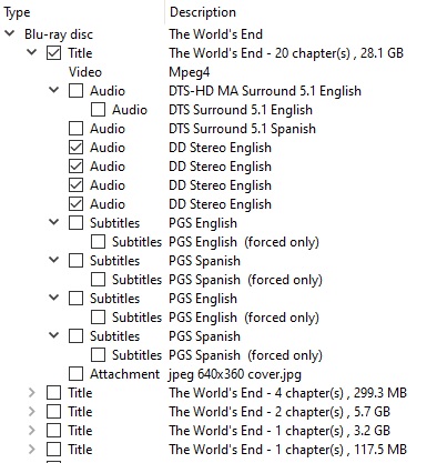

I have been able to rip my DVD's with no problem, but when I try to rip a Blu-Ray,it will be in another language, or have director commentary on, or the latest has some sort of blind compatibility mode on (it has voice over describing what is going on in the scene). I can't figure out how to rip it without this, or is this some setting on the program playing the video back?
These are the settings I was trying:
Ripped Blu-ray Has Blind Compatibility On

Descriptive Audio is a separate track from the normal movie audio. Unfortunately, sometimes it gets selected as the default track.
This topic will help you with selecting other tracks as needed. I have MakeMKV select EVERYTHING, then sort it out later.
- Posts: 4748
Re: Ripped Blu-ray Has Blind Compatibility On
Do you need DD stereo at all? The main track for that movie would be the first one (DTS-HDMA). If your playback device cannot play DTS-HDMA, you can select the 'core' DTS surround track instead by checking the "DTS Surround 5.1 English" checkbox.iconoclastxvii wrote: ↑Wed Jan 01, 2020 8:41 pmI have been able to rip my DVD's with no problem, but when I try to rip a Blu-Ray,it will be in another language, or have director commentary on, or the latest has some sort of blind compatibility mode on (it has voice over describing what is going on in the scene). I can't figure out how to rip it without this, or is this some setting on the program playing the video back?
