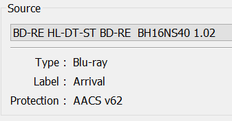

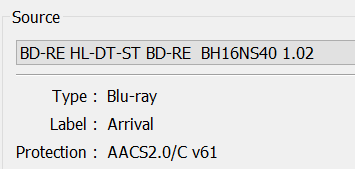

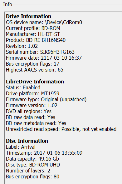

I just ripped Arrival UHD using a BH16NS40 drive with MakeMKV v1.14.5 and the result was a video with voice-over (starting from the opening scene which has no speaking). I also have the BD disc and will rip that to see if I get the same result. I've attached pics to show the Info Panel and the Source Info area.
Source information area
Source info UHD.png (5.81 KiB) Viewed 10735 times
Info panel on right
Info panel on right
Info Panel UHD.png (26.73 KiB) Viewed 10735 times
Not sure why I got voice-over, but the protection on the UHD disc is different than the BD disc:
Source info for BD disc
Source info BD.png (5.55 KiB) Viewed 10735 times

MakeMKV has selection rules for audio and subtitle tracks. The default rule favors "higher quality" (more channels) sources. Some disks use 5.1 or 7.1 for the descriptive audio track, and only Stereo for the movie. Which track do you think wins the selection race?
This topic describes how to manually select tracks when the default rule chooses poorly.
You MIGHT want to consider having MakeMKV select ALL audio tracks, and select which ones to keep later. Remove the unwanted tracks with either mkvmerge or handbrake.
