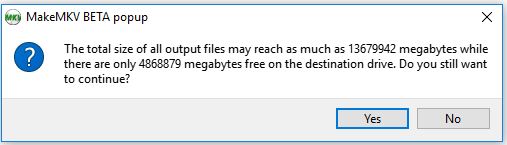

They appear to have found 407 different titles on the disk, and most of the titles are 33.2G in size. If I try to rip the whole disk, I get the following warning:
and indeed, if I let it go, it will run for days and use up terabytes of space. It seems like it wants to rip 400 copies of the 33G file.

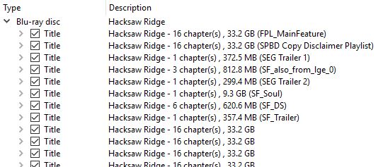

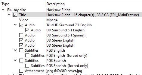

The first entry in the list:
What is the intended operation of this software? Most ripping software I've seen lists just the main movie to rip. Should I only rip the FPL_MainFeature? What are all the rest of the titles for?

Re: MakeMKV creates dozens of files for Hacksaw Ridge
Welcome to the world of Lionsgate Obfuscation. Only the title marked "FPL_MainFeature" is real; the others with "16 chapter(s), 32 GB" next to them are fake, and you can unselect them (hint: RIGHT click with your mouse, "unselect all", then reselect the real titles).
See the sticky message in the general forum, "What is the correct play list [insert title here]?", for more information.
