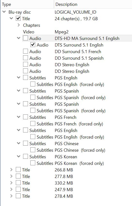

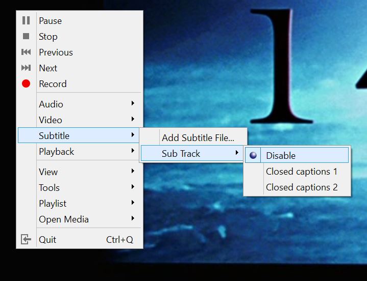

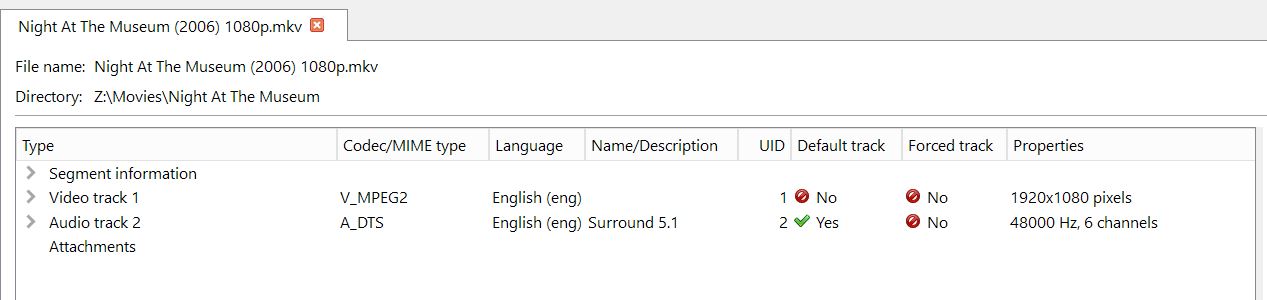

I have seen several posts about Night at the Museum 3 issues, but none related to the problem I am having. For some reason, when I rip Night at the Museum BD with NO subtitles selected I end up with 2 Closed Captions tracks in VLC. I confirmed these do in deed exist, and are a huge pain! I only rip with forced subtitles, and remove ALL others, so i can have them enabled by default in Plex. This is causing a big headache for me, and have not been able to find a way to remove these sub tracks... I have MKVToolNix and am not able to see any sub tracks in that software. I have tried this on both my blu ray drives (ASUS BW-16D1HT Firmware 3.10 patched & Pioneer BD-RW BRD-211M Firmware 1.02) with the same resulting CC subtitle files. I do NOT want to run this through handbrake unless there is a way to keep the original quality of the video and not have a 2x larger file size (I've tried just passthrough, and this has resulted in a massively large .mkv file in the past). Any help removing these WITHOUT degrading the original quality of the video file would be most appreciated!

Closed Captions are part of the video stream, not a separate track. MakeMKV now makes it possible to copy CC out of the video stream into a subtitle stream, but they're still present in the video stream.
If you use handbrake to transcode the file for better compression, the CC text will be removed from the video.
