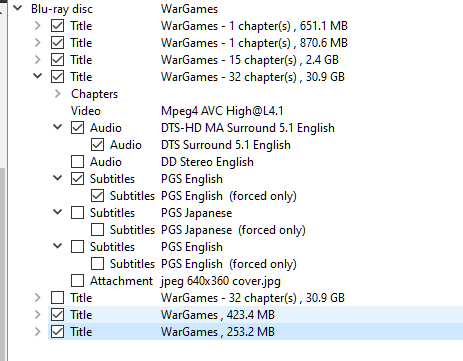

Hi
I have a similar issue to the one described. I'm in the process of trying to rip my WarGames BluRay (UK). The BluRay contains 6 Titles, of which I believe the 4th & 5th are the main feature - I'm basing that belief purely on the fact that the size of each of the is 30Gb which is by far the two largest titles on the disc.
I've attached a screenshot from MakeMKV (BETA edition, running in Expert Mode. As you can see, I've selected the DTS-HD and DTS Surround audio but have deselected DD Stereo English because I believe this contains the audio commentary which I don't want. I've also deselected the PGS Japanese and PGS English subtitles. However, when I ripped the BluRay and play back the resulting MKV file, I'm getting a flawless video but absolutely NO audio.
Is there something silly that I'm doing wrong?
TIA
Screenshot 2021-02-10 151603.png (19.03 KiB) Viewed 16928 times

ianbhenderson73 wrote:
Wed Feb 10, 2021 3:19 pm
You've checked the proper tracks but maybe you have a Default Selection String active that disables them? You could poste the text output of Mediainfo of the resulting MKV so we can verify if VLC should play back audio.
