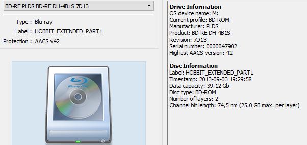

Blue Ray - ILLEGAL REQUEST:COPY PROTECTION KEY EXCHANGE FAIL
- mkv.JPG (36.69 KiB) Viewed 11449 times
Re: Blue Ray - ILLEGAL REQUEST:COPY PROTECTION KEY EXCHANGE
Does it work with ANY BD? Does it work with DVDs?
What version of MakeMKV are you running (that was chopped off in your log)? AACS v42 has been "solved" for several years.
Hi, thanks for the reply
I have not been able to get ANY BD to work
DVD's work just fine
1.10.8 is the version i'm running.
- MakeMKV_log.txt
- (19.53 KiB) Downloaded 400 times
It sounds like your drive has been exposed to a disk with a higher version of AACS than MakeMKV can handle, and has locked out BD functionality. Unfortunately, Hobbit isn't the one (it's v42).
Have you tried playing any particularly new disk in that drive? You don't even have to try ripping it - if the AACS has MakeMKV's key in its revocation list, the drive will refuse to accept it for ANY BD access.
MakeMKV 1.10.8 can handle AACS through v63, I believe (it's on the download page). If there is a newer version "in the wild", Mike will need information on it to fix things. What's the newest releases you have?
to my knowledge, the Hobbit is the newest one I have put in my computer. I don't normally get BD. Just starting to get a few.
nothing i can do from my side to try to resolve the issue?
I'm not sure, really.
Do you have any software in the machine that lets you PLAY BD movies on the computer? Some times, such software uses a "driver" that can interfere with other programs accessing the drive.
I'd suggest contacting Mike (the author) via email at support@makemkv.com and including the AACS dump file that was generated and saved as C:\Users\Master/.MakeMKV/MKB_v42_The_Hobbit_An_Unexpected_Journey_Extended.tgz . If you have other dump files in that directory from attempting to read other BDs, he might ask for those, too.
