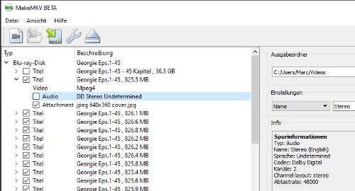

"nolang" did not work for me. I had problems with the Blu-Rays of "Eine fröhliche Familie" and "Georgie":
2019-10-29 11_28_05.jpg (27.39 KiB) Viewed 14023 times
I think its because the language is set to "Undetermined" and not to an empty string.

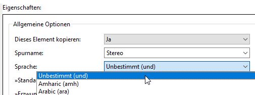

EDIT: Ah ok, regarding MKVToolNix the "language" is "und":
2019-10-29 11_31_46.jpg (18.19 KiB) Viewed 14016 times
So this should work, too
-sel:all,+sel:(ger|eng|tur|nolang|und),-sel:(core),-sel:mvcvideo,=100:all,-10:ger,+sel:attachment
EDIT2: Tested. And yes, "und" selects "Undetermined" audio tracks. :)
