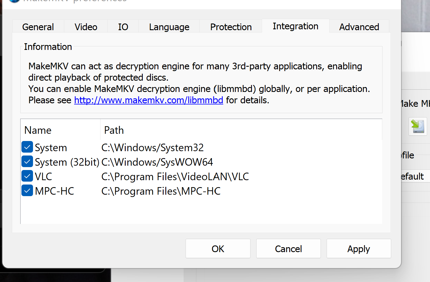

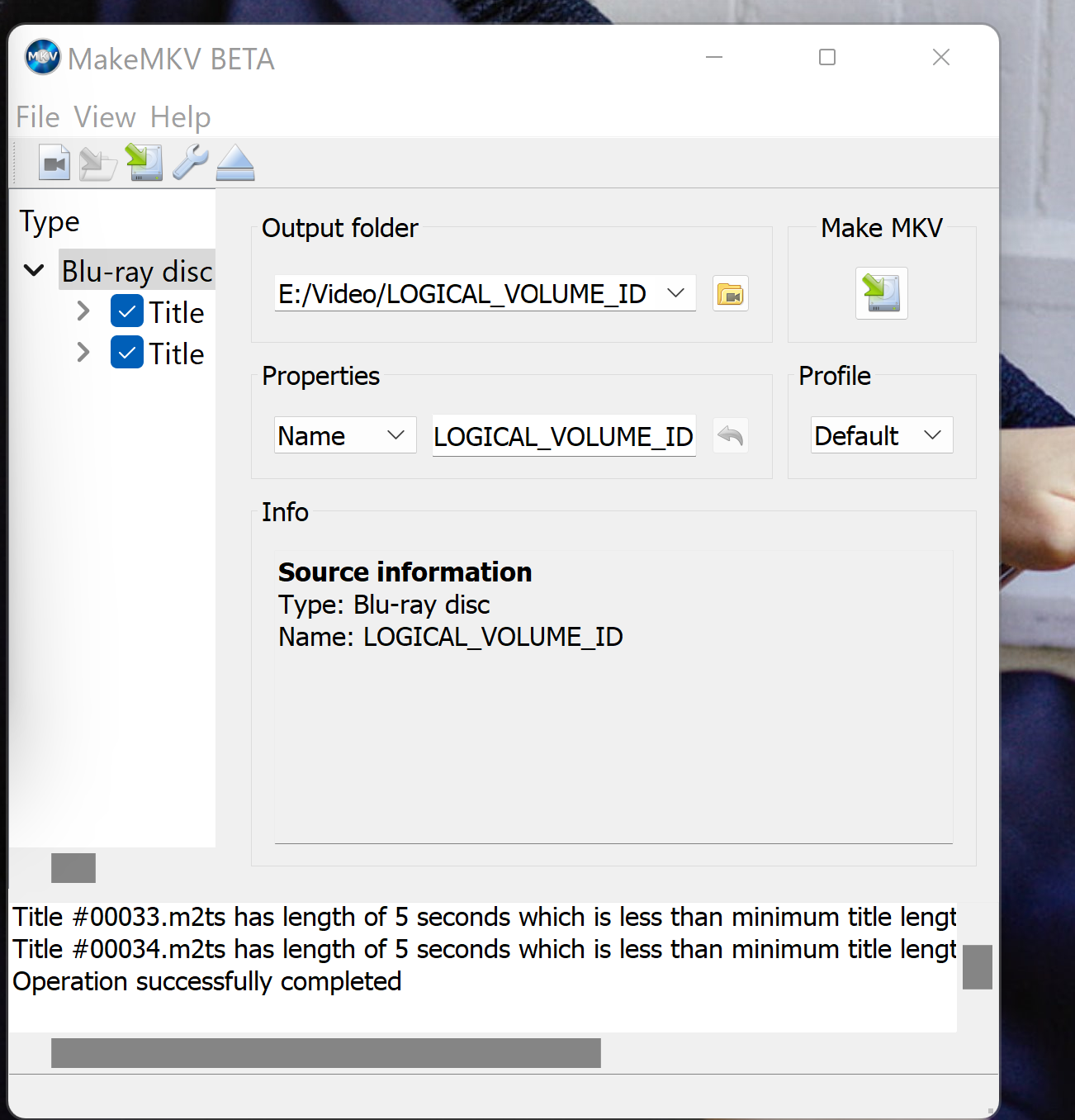

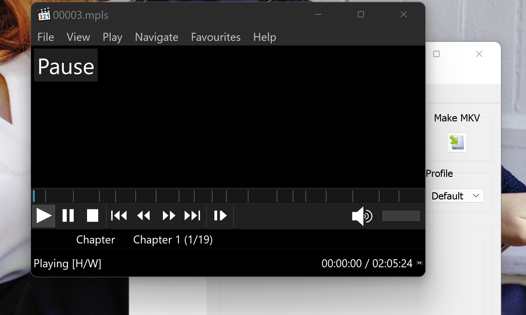

I am using Makemkv with MPC HC on the fly decryption.
Everything were fine up to the time I changed the connection of my second monitor:
it was connected to the AVR and I connected it straight to graphics card display port.
After that I cannot use on the fly decryption with MPC HC.
Java 32 and 64 bits are installed.
I even clean installed windows, but the problem persists.
I even installed VLC but it is also not working.
Any help would be much appreciated.

Make sure you are using the key on your new install and check and uncheck the intagration after making sure your key is in.
Make sure to hit ok in-between checking and unchecking

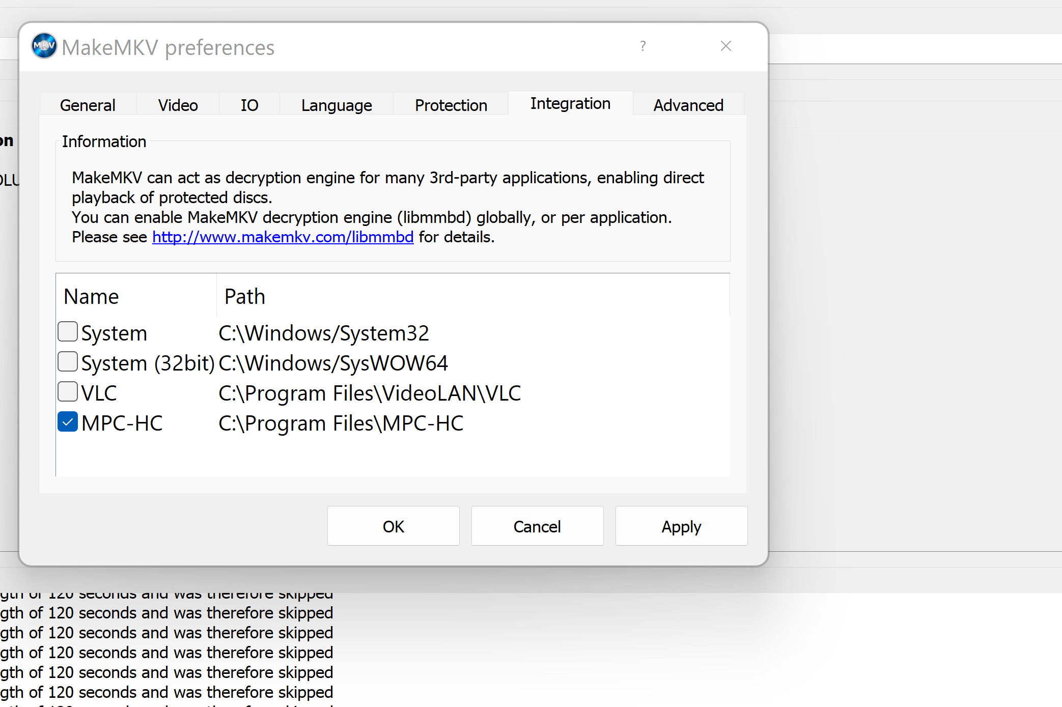

Re: On the fly decription don't working
After a week trying to recover makemkv integration with MP HC, there is no positive result.
I don't care if everyone could use the registration key as it seems to me that it is not valid though I have paid for it.
As you can see in attachments, integration is ticked and makemkv indicates that registration is on.

it does show the chapters maybe your system does not support h.265

This particular disc is Mission Impossible 1, a simple Blu-ray disc.
Using trial version of Anydvd I watched several UHD Blu-ray discs.
I believe that somehow the registration number is not valid.
Using MakeMkv the first five days, I watched UHD Blu-ray discs using MPC HC integration.
This is a simple Blu-ray disc and my system can handle HEVC decoder or any other decoder.

I have seen other problems like this before if there are multiple decryptors in the mpc or vlc folder.
You could try uninstalling both VLC and mpc then reinstall and see if it works that should delete the directorys and any other decoders in there then only add makemkvs decoder

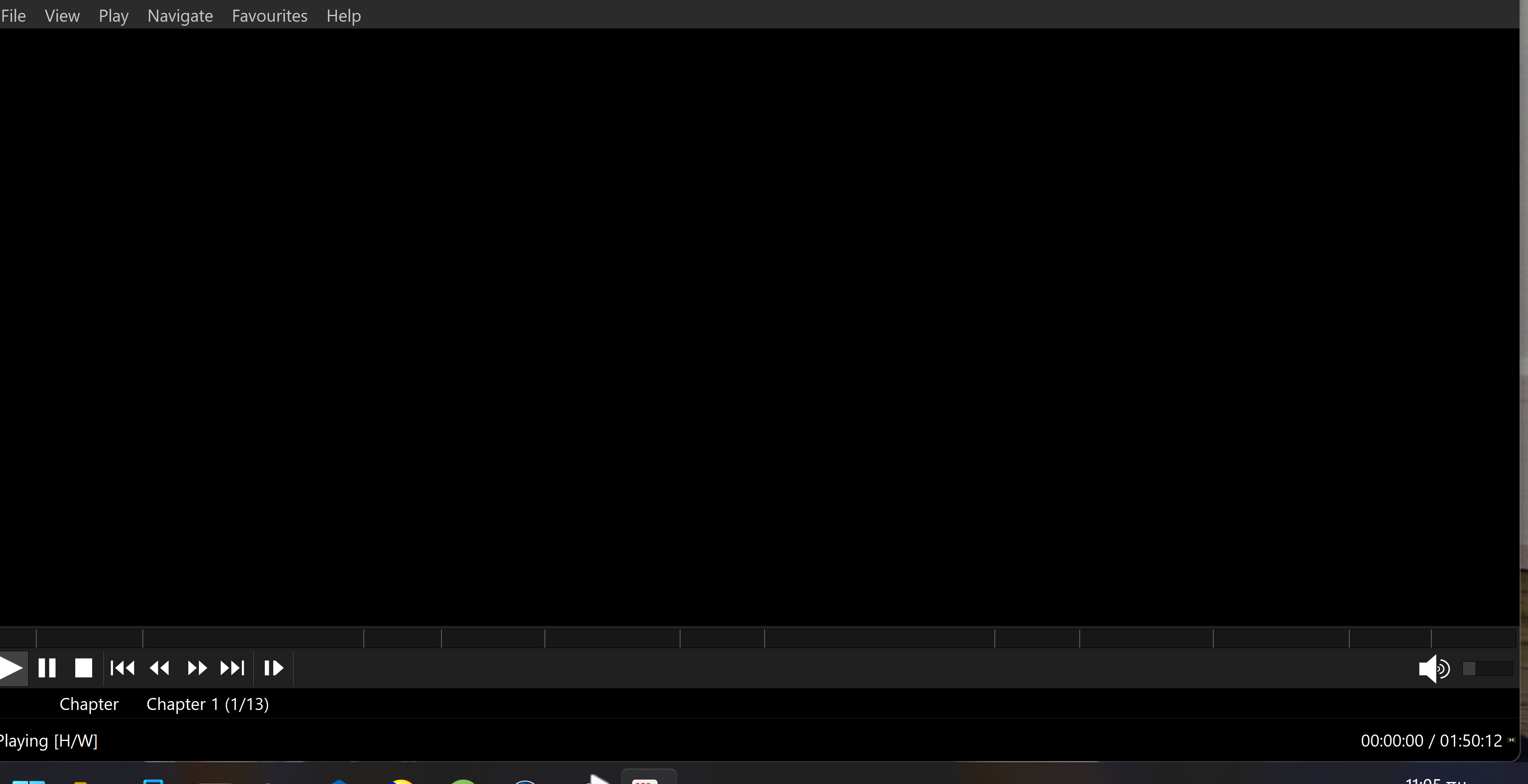

I followed the advice uninstalling all video players ,reinstalling MPC HC but ,though, it opened the disc within seconds ,still black screen.
Is there, any other particular MakeMkv setting , for the integration ? I run MakeMkv as administrator,in Preferences Enable intenet acesss ,Expert mode and AV synchronization messages are ticked ,Language and preffered language are English and in Integration MPC HC is ticked.
