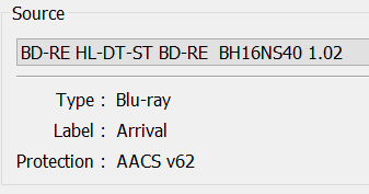

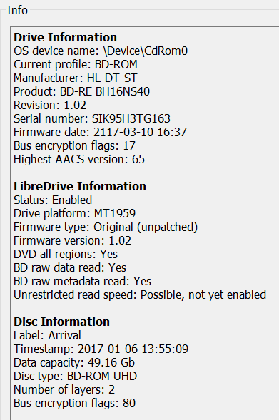

I just ripped Arrival UHD using a BH16NS40 drive with MakeMKV v1.14.5 and the result was a video with voice-over (starting from the opening scene which has no speaking). I also have the BD disc and will rip that to see if I get the same result. I've attached pics to show the Info Panel and the Source Info area.
Source information area

Info panel on right
Info panel on right
Info Panel UHD.png (26.73 KiB) Viewed 10463 times
Not sure why I got voice-over, but the protection on the UHD disc is different than the BD disc:

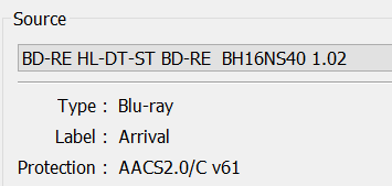

Source info for BD disc
Source info BD.png (5.55 KiB) Viewed 10463 times
