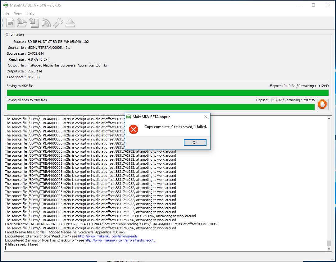

Tried again and the following happened:
any suggestions would be appreciated.
Sorc Apprent Error.PNG (117.68 KiB) Viewed 15328 times

Have you tried cleaning the disc first? Sometimes even a brand new disc out of the case can not be clean enough. I am now cleaning every new disc I get with disc cleaner and a microfiber cloth and have not had any failures. Just an idea.

I did try cleaning, it, but I will try microfiber and not just my shirt. :wink:

thedukeo8 wrote:I did try cleaning, it, but I will try microfiber and not just my shirt. :wink:
Us a solution of 50/50 distilled water and rubbing alcohol along with a microfiber cloth.
I also use a microfiber cloth for cleaning my glasses and it works great.
