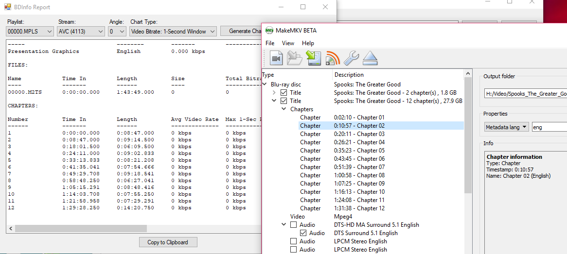

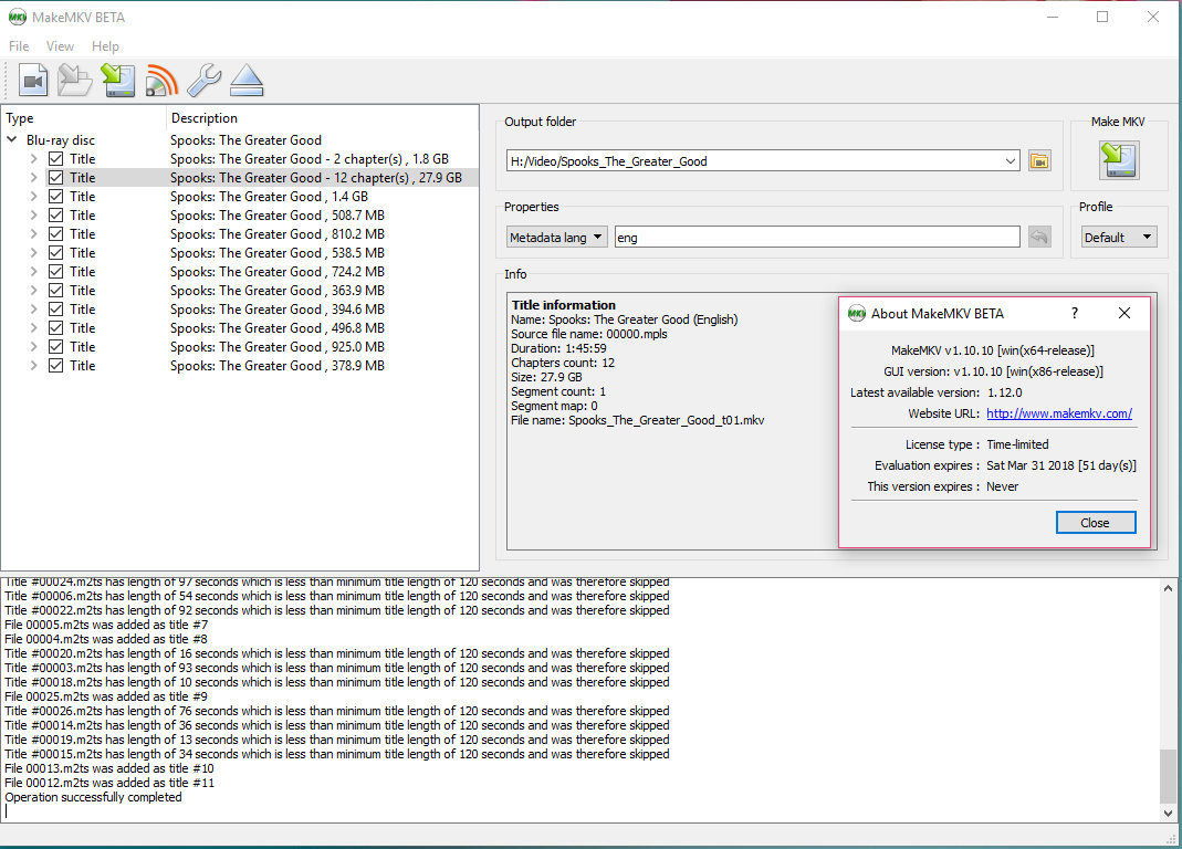

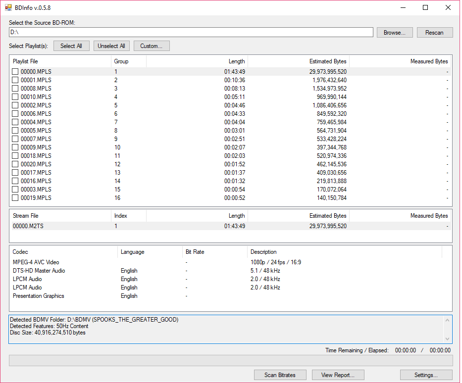

Power DVD reports a length of 01:43
BDInfo reports 01:43:49
MakeMKV reports 01:45:59
What's odd, is all the chapters seem off by 02:10, which is when that Test card etc ends, and the film begins.
- hm,mm - Copy.png (57.68 KiB) Viewed 21758 times
- BDInfo.png (36.07 KiB) Viewed 21759 times
- makemkv.png (82.33 KiB) Viewed 21759 times
