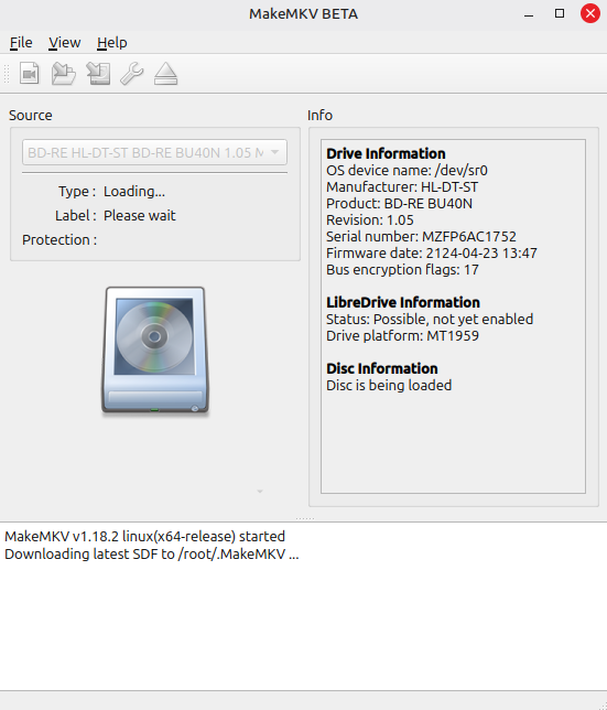

When starting MakeMKV with debug log enabled, I see this output when trying to access the disk:
Debug log started at Wed Nov 26 13:14:02 2025 , written by MakeMKV v1.18.2 linux(x64-release)
001005:0000 MakeMKV v1.18.2 linux(x64-release) started
001004:0000 Debug logging enabled, log will be saved as file:///home/freddy/MakeMKV_log.txt
Network access is ENABLED, CURL version 8.5.0/OpenSSL/3.0.13/1.59.0 (x86_64-pc-linux-gnu) , proxy server not set.
001003:0020 DEBUG: Code 0 at [$&!cPHsNoNC,vJT%<05$ :29393631
No  SDF v0a3: HL-DT-ST_BD-RE_BU40N_1.05_212404231347_MZFP6AC1752
SDF id v0a3: HL-DT-ST_BD-RE_BU40N_1.05_212404231347_MZFP6AC1752
The software keeps showing "Loading disk" on the screen but doesn't do anything else. It's stuck at this point.
Creating an ISO file from the same Blu-Ray with dd and opening the image with MakeMKV, everything works fine, and I get the same debug output as above followed by
005053:0608 This functionality is shareware. You may evaluate it for 30 days after what you would need to purchase an activation key if you like the functionality. Do you want to start evaluation period now?
005050:0000 Evaluation version, 30 day(s) out of 30 remaining
005085:0000 Loaded content hash table, will verify integrity of M2TS files.
DEBUG: Code 2147483648 at J9nz|TUj[9tsqH);:121265499
003338:0000 Downloading latest HK to /home/freddy/.MakeMKV ...
001003:0020 DEBUG: Code 0 at J9nz|TUj[9tsqH);:121267063
So, how can I narrow this down? I don't get any debug information besides the above mentioned, no errors either in the debug log or ring buffer or anywhere else...
MakeMKV-Screenshot from 2025-11-26 15-00-20.png (68.67 KiB) Viewed 2946 times
