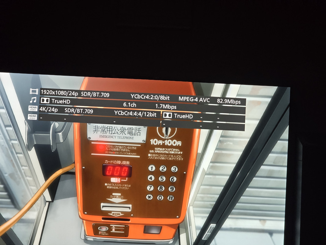

According to by UB9000 the bitrate is going unusually high in spots where it otherwise shouldn't (isn't the max bitrate for video on Blu-ray 40mbps?) I don't know how makemkv can appropriately cope with this assuming it *can* cope with this. The only other time I've seen bitrates that high is with an episode of Better Call Saul (the episode where Saul impersonates Howard and that was a mere 61mbps).

Which video decoder are you using? It might be worth trying out software decoding via LAVFilters to see if it handles seeking more gracefully than whichever hardware decoder you are currently utilising.
sephirothkefka wrote:
Sun Oct 26, 2025 8:02 am
There is nothing more for MakeMKV to do here. It has done its job of decrypting, verifying and repackaging the content from your disc into a Matroska file. The visual corruption you are seeing is a shortcoming of your playback configuration. It is in no way indicative of corruption within the actual Matroska file.
Remember, MakeMKV isn't acting like an analogue video capture card frantically trying to grab every ephemeral frame on the wire. It is completely indifferent to the bitrate used to encode the content. The bitrate obviously matters for hardware players trying to playback content in real time but MakeMKV would happily rip a disc mastered at 400Mbps if you gave it one. It wouldn't happen in real time but that doesn't matter for its intended use case.
