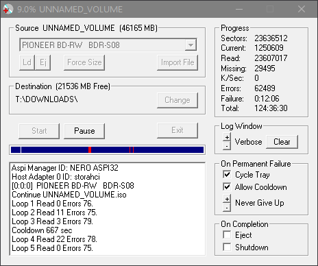

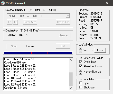

Some screenshots/graphics for better illustration:
ISOpuzzle after 27:34:59
ISOpuzzle after 124:36:30

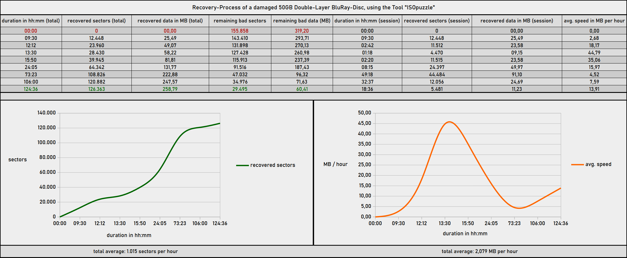

Statistic / Diagram of the whole Process
Overall average: ca. 1000 Sectors (or 2 MB) per hour.
So 81% of all "marked as bad" sectors from the first run were recovered!
Which is amazing, as I never expected such a high score.
At this point I stopped the process, because the number of successful read sectors per loop reached a one digit level and often was zero.
So the ratio of recovered sectors vs. running time diverges too far.
