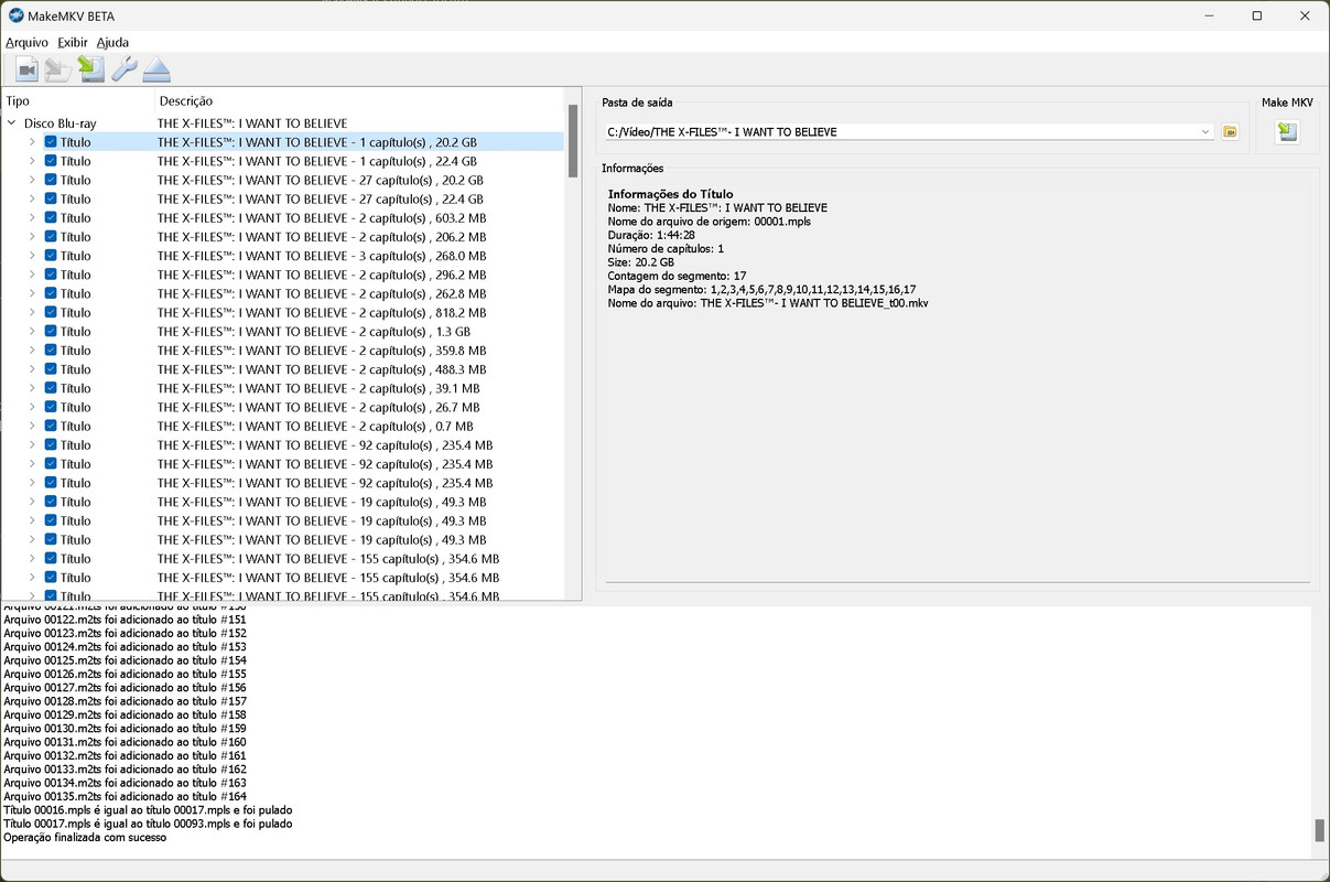

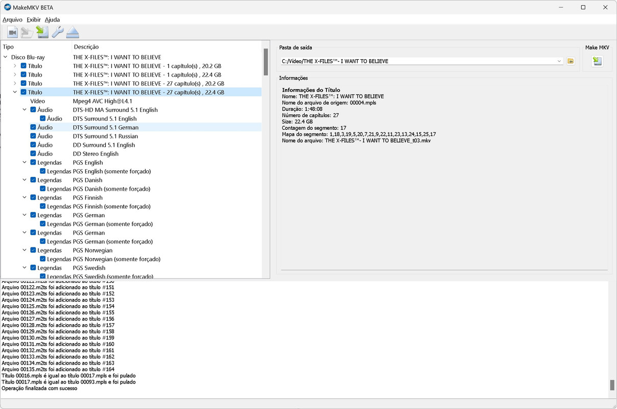

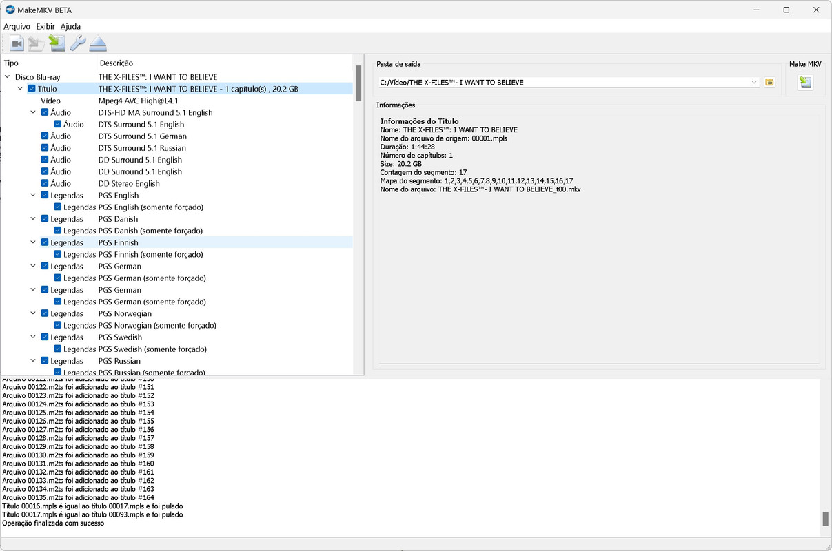

This is what MAKEMKV showed while checking this disc (already in my SSD). In my case, the disc is not from the U.S.:
https://i.postimg.cc/NG1s9WMH/S1.jpg
https://i.postimg.cc/6p1txKHD/S2.jpg
https://i.postimg.cc/KvfmQBtc/S3.jpg
https://i.postimg.cc/BQ4qxMLw/S4.jpg
https://i.postimg.cc/nhLpWr14/S5.jpg
Can you see any indication there's a DTS-Express 2.0 track there? (Remember this is the commentary track for the PiP).
Or the secondary video stream, which is in 480p / 23,976 fps / 16:9 / High Profile 3.2, and not 1080p / 23,976 fps / 16:9 / High Profile 4.1?
No. The four 20 GB options MAKEMKV show in those POSTIMG screens do not include PiP. AT ALL. Completely ignored.
Now, oddly MAKEMKV shows plenty of smaller files to be copied as MKVs, which I assumed to be extra features.

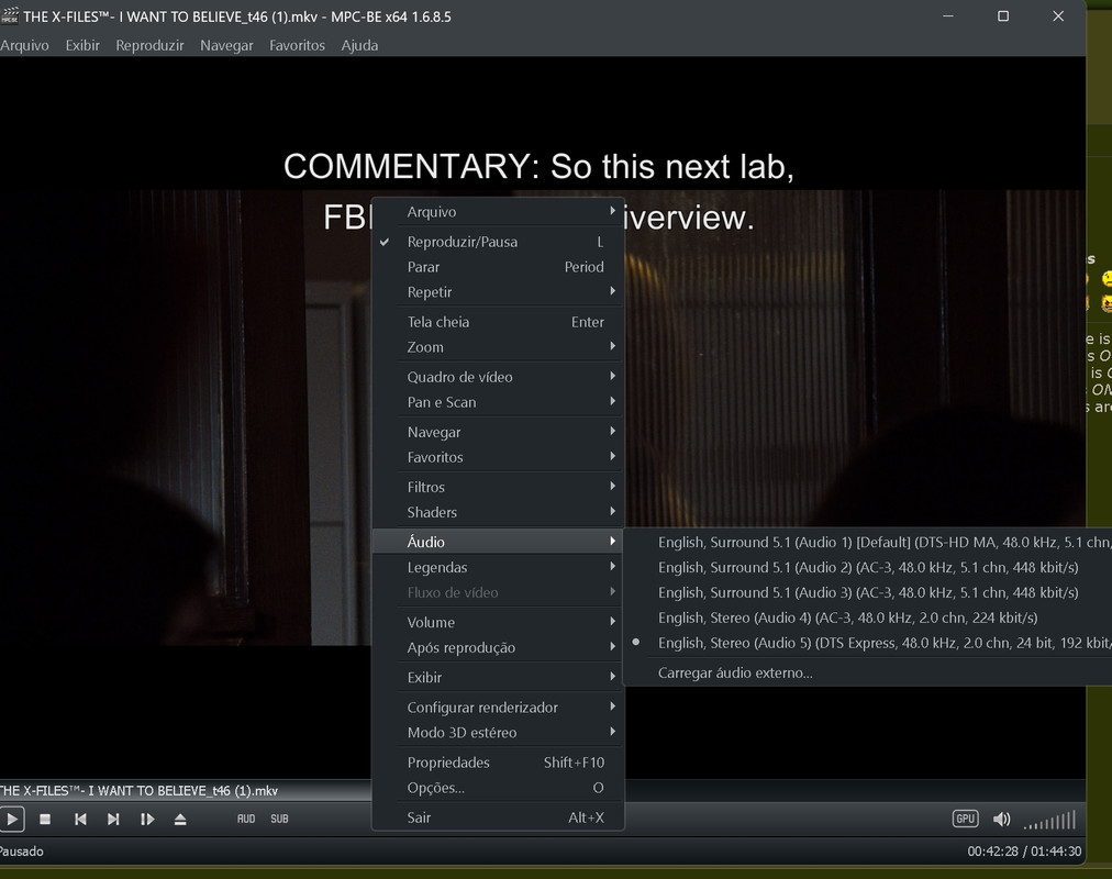

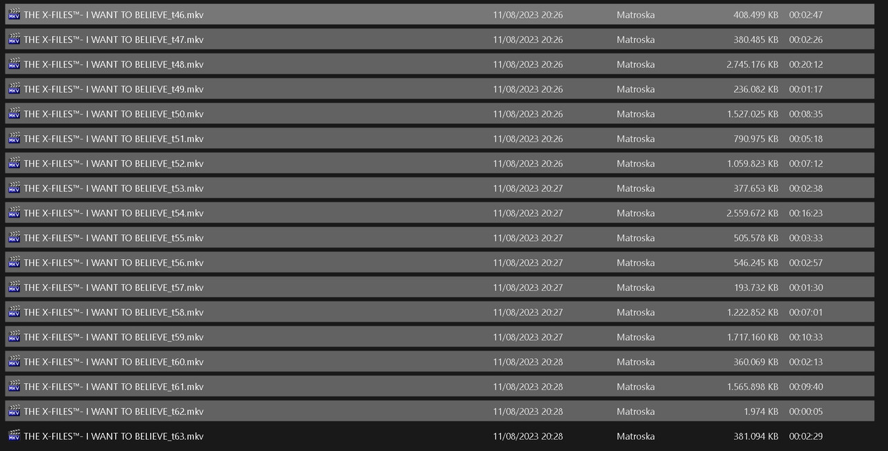

Yet, not all of them are. After I used MAKEMKV, I noticed that file-46 was from the movie (first 2 minutes), but it featured the DTS-Express 2.0 track.
Look:
https://i.postimg.cc/Wbw0nW9D/DTS2.jpg
Then, we go to file-47 with another 2 minutes; file 48 with 20 minutes, file 49 with 1 minute and so on.

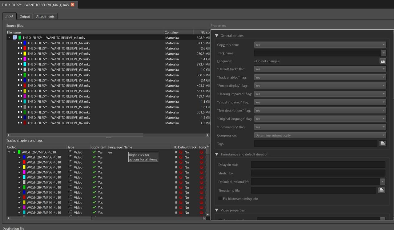

If all of them combined make a single movie, then I have to merge all of these:
FILES 46 through 62:
https://i.postimg.cc/RFvWN4BX/MERGE.jpg
The problem is that even if we could only have the entire 2h movie with the PIP commentary, it was MAKEMKV's job to merge all these parts, not mine. I had to "append" all of them, using MKVTOOLNIX:
https://i.postimg.cc/6q0gtVhM/APPEND.jpg
MKVTOOLNIX also warned me about this:
The codec's private data does not match. Both have the same length (127) but different content. Please make sure that the resulting file plays correctly the whole time. The author of this program will probably not give support for playback issues with the resulting file
13 times.

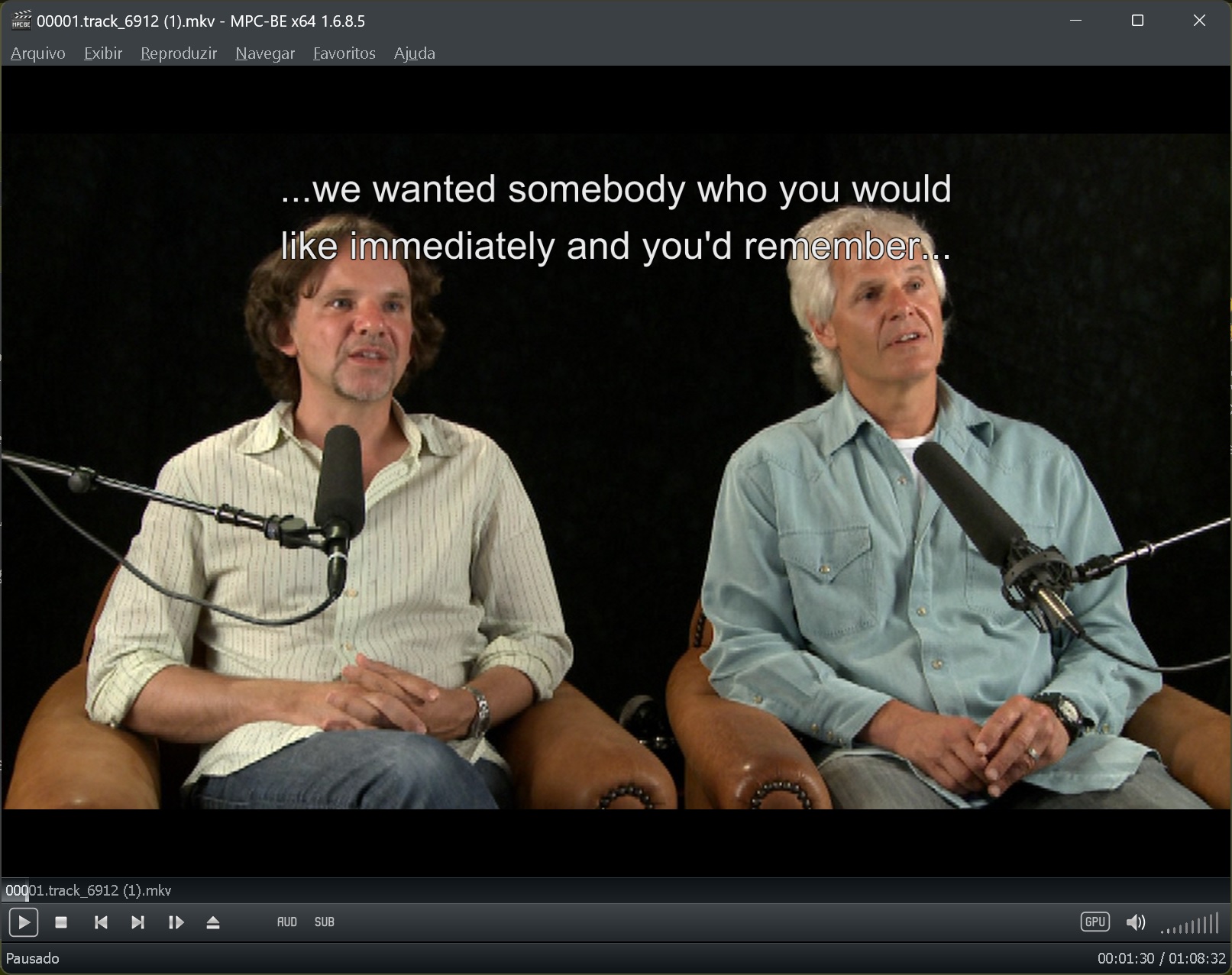

The end result has 1h44m (theatrical), and the DTS-Express track is there. All good, right? Well... no.
https://i.postimg.cc/VLbzPvrn/END-RESULT.jpg

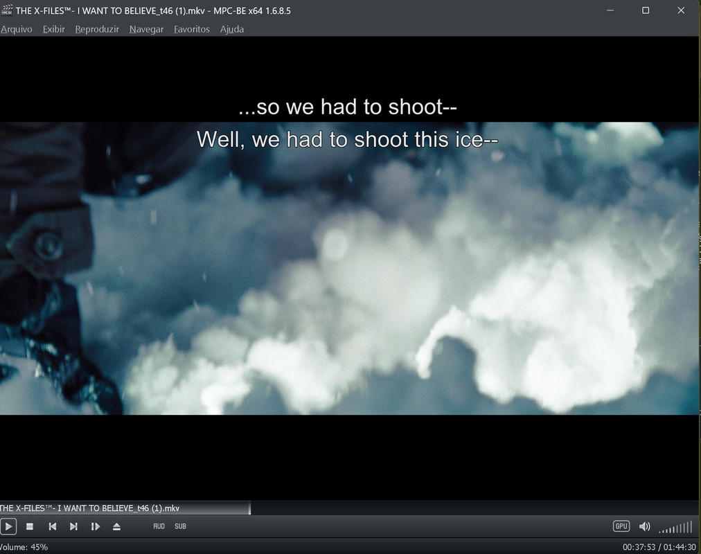

This scene from the screenshot is in sync the subtitles and the PIP commentary. But if I check other moments, such as 11m50s, the subtitle is out of sync a few seconds. And in several other moments the same subtitles are that way. Which makes no sense... until you think about it WHY.
The PIP commentary has only 1 hour recorded, probably; same for the PIP video. The disc itself activates both when needed, but when they should not appear, the authoring fill these gaps with SILENCE / NOTHING. But when MAKEMKV ripped in this fashion, everything broke. And how do I know there's silence?
Checking the END RESULT; for example, at 37m52s, the file is silent, but the subtitles are still being displayed:
https://i.postimg.cc/brGXHVc4/SILENT.jpg
To sum things up, even this idea of appending all these parts... FAILED.

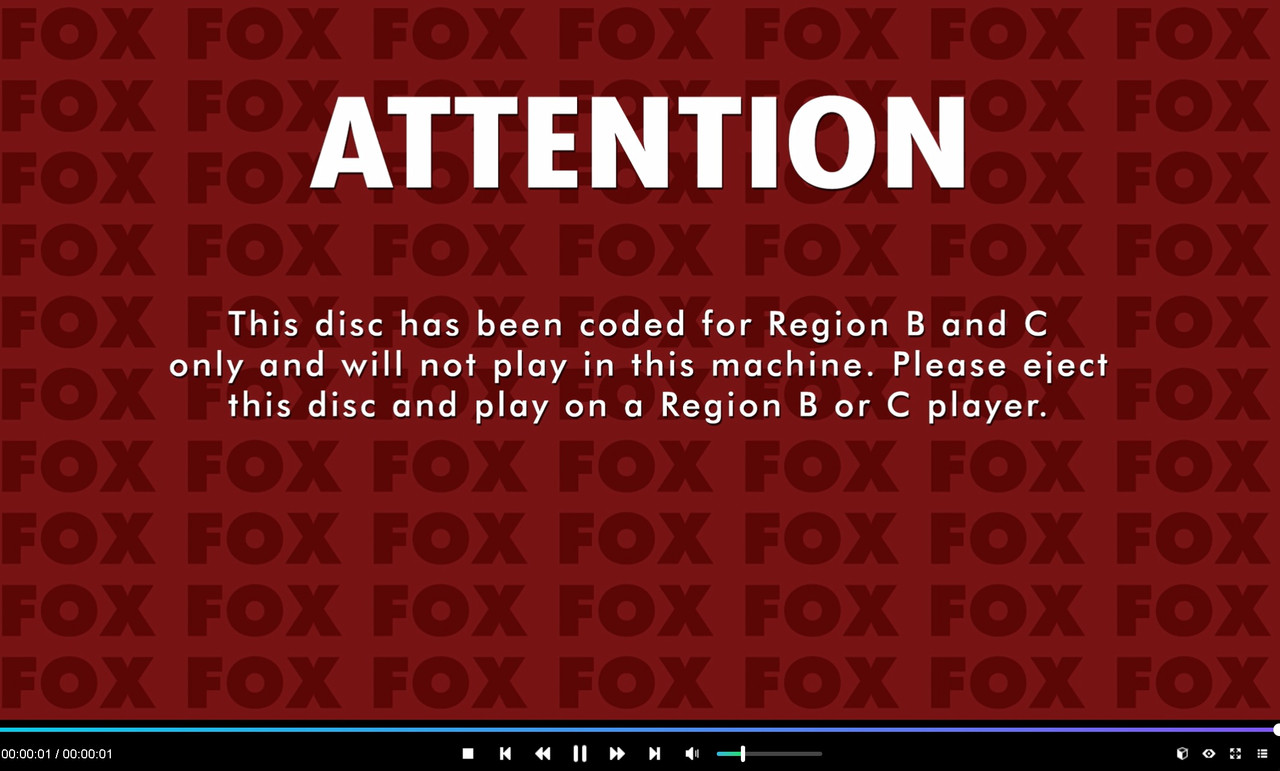

And that's not all: even AnyDVD-HD was not helping me:
PlayerFab and PowerDVD were not capable of playing the Blu-ray folders in my SSD.
This is what they both showed:
https://i.postimg.cc/jdjx5Tgd/RBC.jpg
Do I need to rip this again? My drive is region A, and has already been set to R-4 (Brazil). So, 4 changes left.
