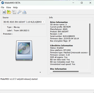

so my sons entire football season was captured in 4k, at 100$/disc, I decided to buy ONE and make copies for the family, did my research and ended up buying an Asus bw-16d1x-u drive (someone had posted the exact same drive I was looking to purchase and our libredrive matched perfectly, he was able to flash his so I figured I'd be in the same boat) downloaded the SDFtool Flasher & the MartyMcNuts (awesome name BTW) all in one firmware, now the person with the same drive as me had issues flashing Asus 3.10 MK and flashed wh16ns60 1.02 mk, I ended up flashing the 3.10 MK (didn't work for the other guy but seemed to work for me) once that was done, loaded up makemkv and here's where the issues started, clicked on backup at the top and made a copy of the disc to my hdd, was getting some errors during this process, but it appeared to copy mostly everything, clicked on open files to begin the conversion process and it would come to an error and say it's "trying to work around it" and then I watched the remaining time balloon into 10+hrs, I figured this HAS to be wrong, so I moved the files makemkv "ripped" to my nvme drive (2tb) and tried again thinking MAYBE the slower hdd speeds were somewhat of a factor, I would either get the same ballooning times or just a complete stop error, using cyberlinks power2go I was able to make a 1:1 iso copy of the disc, I'm even able to open up the disk drive in Explorer and actually copy the files from disc to the hdd (I did this thinking I could overwrite the "bad" files, to my dismay, that did not work) I currently have unifab making a merged mkv of the files I copied to the nvme, I have sat and played everyone of them in vlc and they play w/o issues, as well as from the disc itself (also watched in vlc) I have zero. clue how to movie forward and from everything that I see, I want to make using makemkv my default process for ripping Blu-ray into mkv, any help would be GREATLY appreciated...

you can see each step I took as well as the errors I got, tried from disc, didn't work, ripped it to hdd then tried from there and got essentially the same error, any help would be greatly appreciated
first open makemkv:
disc info:
rip errors:
conversion error:

Error 'Internal error - Operation result is incorrect (232)' occurred while reading '/BDMV/STREAM/00029.m2ts' at offset ‘1756262400'
Failed to save title /BMV/STREAM/00029.m2ts to file G:/Video/backup/Team 100-2023 S/BDMV/STREAM/00029.m2ts
^ That's an example from the 'rip errors' picture if you click through. I don't think I've seen that particular error before.
The screenshot at this link suggests that there's no encryption on the disc. I wonder if you could use MakeMKV to make a backup of the disc & then open the backup in MKVToolNix to create .mkv files from there.
The disc might be authored in a way that MakeMKV can't understand. MKVToolNix seems better at handling odd cases than MakeMKV.

also to answer another persons post on this thread, the blu-ray isn't just a bunch of video files on a disc, it is actually authored (menus, scenes, etc) granted it doesn't have the disc encryption as a store-bought dvd would, but it's far from just a "bunch of files on a disc" if that makes sense...
