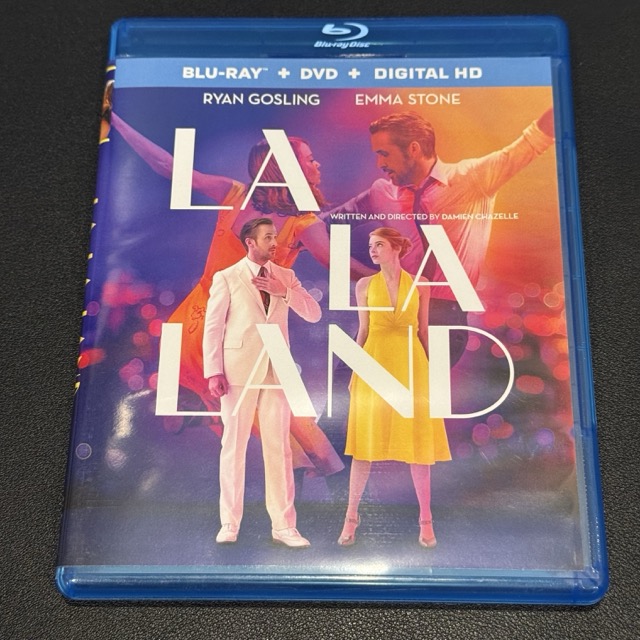

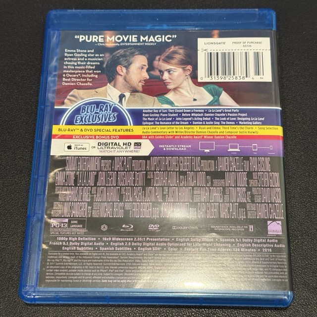

This is an old thread which mentions possibility of unique editions for Target and other retailers. But it's 2025 and Target is still selling blu-rays but Best Buy has gotten out of the blu-ray business.
I just picked up this movie from Target in the U.S. which includes the blu-ray and DVD in the same box. The following playlist is correct (matches the MPLS and segment map at the top of this thread):
Title information
Name: La La Land
Source file name: 00620.mpls
Duration: 2:07:48
Chapters count: 16
Segment count: 15
Segment map: 509,512,506,501,515,505,502,507,504,503,508,510,514,511,513
File name: La La Land_t264.mkv
The UPC is on the back:
0 31398 25838 4 80
without spaces:
03139825838480
without the last 2 digits, which may be a UPC+2 supplemental information:
031398258384
