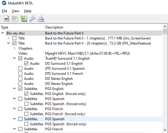

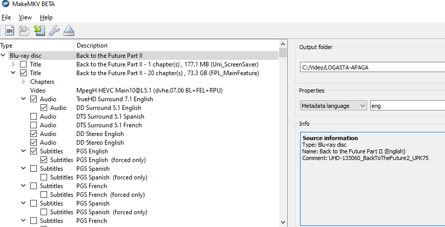

OK, these are the files requested. Use 7-zip or WinRAR:
https://www.dropbox.com/s/qbxm7tqd4wt2w ... 4K.7z?dl=0
First file has 540 MB, second has 82.
For optionA I selected the Atmos track, DD 5.1 derived from it, and also the 2 commentary tracks. And the english subtitle.
For optionB I didn't select the Atmos track. Included: DD 5.1 derived from the Atmos, the 2 commentary tracks, and the english subtitle.
