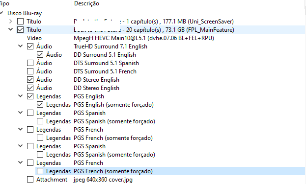

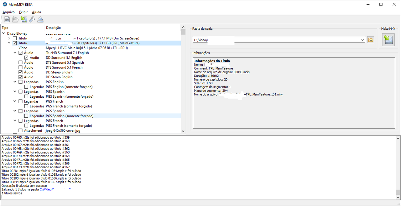

I did some digging and decided to save the original UHD/4K again as MKV.
I think I am onto something important. Bear with me...
First of all, the main feature, which is the movie (73 GB size, more or less...) has Dolby Atmos to be selected as 1st track, then in the box below ENGLISH DD 5.1, then DD 5.1 spanish, DD 5.1 french, and 2 more audio tracks, which I confirmed to be audio commentaries.
This is title #2, and MAKEMKV says it has read from 00040.mpls.
There's another duplicate of the movie in that screen, which says it's reading from 00294.m2ts. Same tracks.
About this title #2, I had this problem after selecting:
- Dolby Atmos
- DD 5.1 English
- The 2 audio commentaries
- English subtitles
So I went back and only saved the video, and nothing else.
No problem.
I went back again and saved the video and...
- Dolby Atmos
- DD 5.1 English
No problem. NO WARNINGS! And this goes for title #2 and the duplicate.
However, once I selected the 4 audio tracks + the subtitle, the problem happened AGAIN.
A/V synch issues.
This is veeeeeeeeeeeeeeeeeeeeeeeeeeeeeeeeeeeeeeeeeeeeeeeeeeeeeeeeeeeeeeeeeeeeeeeeeeery strange, since I said Dolby Atmos was probably the culprit. It turns out the A/V synch issue only happens with further tracks being selected.

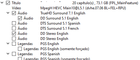

More tests:
>>>>>>> What if we select the first two audio tracks (Atmos and 5.1 english) and the english subtitles? (TITLE #2)
A/V synch issues. Now we have to look what happens if we select the other 2 audio tracks.
>>>>>>> What if we select only the first three audio tracks? (TITLE #2)
- Dolby Atmos
- DD 5.1 English
- 1st audio commentary
Like this:
Result: No problem.
FINAL TEST: selecting ALL audio tracks, and leaving the subtitle out.
No issues.
Proof: LINK
So the fact I selected that english subtitle was what triggered this issue. Did you see that? Not a single warning after I selected:
- Dolby Atmos
- DD 5.1 English
- Audio commentary #1
- Audio commentary #2
What do you have to say now?

- First of all, the movie mentioned (BTTF Part II) is UHD/4K (and before I was talking about part 1).
- The UHD/4K is already decrypted and all folders are in my SSD drive. I mean BDMV/STREAM and all others.
- Then I told MAKEMKV to open this local folder, and save as MKV.
Option A: if I select the Dolby Atmos track (with all others, or a few others), then we will have a broken file.
Audio dropout, freezing in a specific moment of the movie and then continuing (for 250 ms or 500 ms, more or less)... the usual abnormalities (that you may or may not spot) because MAKEMKV says "A/V SYNC ISSUES" at the end.
Option B: if I do not select the Atmos track, the file is generated by MAKEMKV without the same issue, because at this same specific moment of the movie there will be no freezing.
So what mike is asking me makes no sense, because there was no MKVTOOLNIX interference here. I only edited LATER and whatever edit I made had no bearing in fixing or not.
The point is: A/V SYNC ISSUE entails a bug related to the Atmos track that is also damaging the video itself.
It's like the Atmos track is a virus that is also corrupting the video. That's why MKVTOOLNIX later showed this bug more clearly for me, but MKVTOOLNIX didn't make any difference in what we are discussing here.
At first I thought this was MKVTOOLNIX fault, but it turns out this is 100% MAKEMKV's doing.
