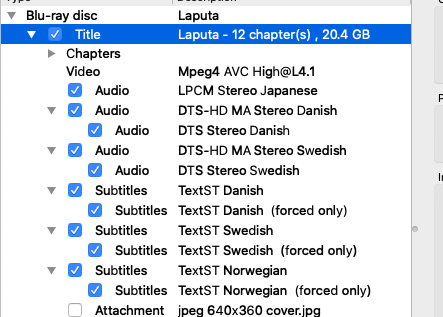

Two possibilities, considering the partial logs.
Did you, perhaps, ONLY select the "forced only" subtitles? If so, there were none to be found:
Forced subtitles track #3 turned out to be empty and was removed from output file
Forced subtitles track #5 turned out to be empty and was removed from output file
Forced subtitles track #7 turned out to be empty and was removed from output file
The other is that you have set a "preferred language", which will not select subtitles unless they are tagged as that language. This is less likely, because it did try to find forced subtitles.

Maybe a screenshot from the MakeMKV window will help where all titles with Audio and Subtitle streams are seen (Chapters can be fold)
steinmb
Joined: Fri Apr 14, 2017 2:48 pm
Re: Laputa - No usabel subtitles found in the MKV result file
Post by steinmb »
Hi and thank you for you replies.
Sorry I was slow to reply. Need to check my forum notification settings...
Makemkv overview
Makemkv overview
Screenshot 2020-09-15 at 09.34.40.png (51.99 KiB) Viewed 15234 times

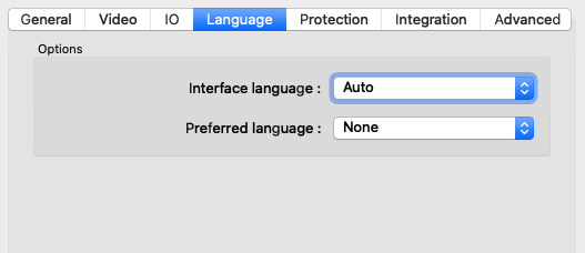

I selected as usual to extract all subtitles. Like this.
Makemkv settings
Makemkv settings
Screenshot 2020-09-15 at 09.36.02.png (18.09 KiB) Viewed 15234 times
Makemkv overview lang
Screenshot 2020-09-15 at 09.43.43.png (32.66 KiB) Viewed 15234 times

You can get details for MKVs with Mediainfo, just switch to text output and post it here.

I figure you are referring to the util named Mediainfo. Here we go:
General
Unique ID                                : 2935397342335896775241402639040736215 (0x23556434647EFC320CC2115A2996BD7)
Complete name                            : /Volumes/Staut/Non_backup/Laputa_t00.mkv
Format version                           : Version 2
File size                                : 18.1 GiB
Duration                                 : 2 h 5 min
Overall bit rate                         : 20.6 Mb/s
Movie name                               : Laputa
Encoded date                             : UTC 2020-09-11 11:10:55
Writing application                      : MakeMKV v1.15.2 darwin(x64-release)
Writing library                          : libmakemkv v1.15.2 (1.3.10/1.5.2) darwin(x64-release)
Video
ID in the original source medium         : 4113 (0x1011)
Format                                   : AVC
Format/Info                              : Advanced Video Codec
Format profile                           : High@L4.1
Format settings                          : CABAC / 4 Ref Frames
Format settings, CABAC                   : Yes
Format settings, Reference frames        : 4 frames
Format settings, GOP                     : M=3, N=24
Codec ID                                 : V_MPEG4/ISO/AVC
Duration                                 : 2 h 4 min
Bit rate                                 : 15.0 Mb/s
Maximum bit rate                         : 35.0 Mb/s
Width                                    : 1 920 pixels
Height                                   : 1 080 pixels
Standard                                 : NTSC
Chroma subsampling                       : 4:2:0
Bit depth                                : 8 bits
Scan type                                : Progressive
Bits/(Pixel*Frame)                       : 0.302
Stream size                              : 13.1 GiB (72%)
Color primaries                          : BT.709
Transfer characteristics                 : BT.709
Matrix coefficients                      : BT.709
Audio #1
Format                                   : PCM
Format settings                          : Little / Signed
Codec ID                                 : A_PCM/INT/LIT
Bit rate                                 : 1 536 kb/s
Channel(s)                               : 2 channels
Frame rate                               : 30.000 FPS (1600 SPF)
Bit depth                                : 16 bits
Stream size                              : 1.34 GiB (7%)
Title                                    : Stereo
Language                                 : Japanese
Audio #2
ID in the original source medium         : 4353 (0x1101)
Format                                   : DTS XLL
Commercial name                          : DTS-HD Master Audio
Bit rate                                 : 1 649 kb/s
Channel layout                           : L R
Stream size                              : 1.44 GiB (8%)
Title                                    : Stereo
Language                                 : Danish
Audio #3
Format                                   : DTS
Bit rate                                 : 768 kb/s
Stream size                              : 685 MiB (4%)
Title                                    : Stereo
Language                                 : Danish
Audio #4
ID in the original source medium         : 4354 (0x1102)
Format                                   : DTS XLL
Bit rate                                 : 1 008 kb/s
Bit depth                                : 16 bits
Stream size                              : 897 MiB (5%)
Title                                    : Stereo
Language                                 : Swedish
Audio #5
Format                                   : DTS
Bit rate                                 : 768 kb/s
Bit depth                                : 16 bits
Stream size                              : 684 MiB (4%)
Title                                    : Stereo
Language                                 : Swedish
Text #1
ID in the original source medium         : 6144 (0x1800)
Format                                   : TEXTST
Codec ID                                 : S_HDMV/TEXTST
Codec ID/Info                            : Text based subtitle format used on BDs
Duration                                 : 2 h 2 min
Bit rate                                 : 54 b/s
Count of elements                        : 787
Stream size                              : 49.2 KiB (0%)
Language                                 : Danish
Text #2
Format                                   : TEXTST
Duration                                 : 1 h 59 min
Bit rate                                 : 57 b/s
Count of elements                        : 837
Stream size                              : 50.0 KiB (0%)
Language                                 : Swedish
Text #3
Format                                   : TEXTST
Duration                                 : 2 h 0 min
Bit rate                                 : 55 b/s
Count of elements                        : 859
Language                                 : Norwegian
Menu
00:00:00.000                             : en:Chapter 01
00:10:44.101                             : en:Chapter 02
00:21:09.184                             : en:Chapter 03
00:31:35.602                             : en:Chapter 04
00:43:42.244                             : en:Chapter 05
00:51:46.103                             : en:Chapter 06
01:03:59.502                             : en:Chapter 07
01:12:56.663                             : en:Chapter 08
01:25:53.565                             : en:Chapter 09
01:34:02.094                             : en:Chapter 10
01:45:10.971                             : en:Chapter 11
02:01:41.585                             : en:Chapter 12

The output suggests that there are subtitle tracks in your MKV file. It also says they're of type:
Which is a legit format it seems: https://www.matroska.org/technical/subtitles.html
It is, however, uncommon I think. I searched through all my MKV files and I only have 1 movie that has a subtitle track in that format. When I play that 1 particular MKV file in a utility like mpv, it tells me the subtitle track is there, but won't play it. It seems like the most recent version of VLC will play it, however.
This post https://forum.videohelp.com/threads/394 ... tle-format suggested a way to convert the subtitles to a different format.

Right, a not much used non image based format. I'll try if I can find someone with a windows machine I could borrow for a few hours. Thank you for helping out with a issue that turned out to be Makemkv unrelated.

Post by Chetwood »
You could set up Win 10 in a Virtualbox machine and install it there. Microsoft's Media Creation Tool lets you download an ISO to install from and as long as you don't activate you can use it freely.
