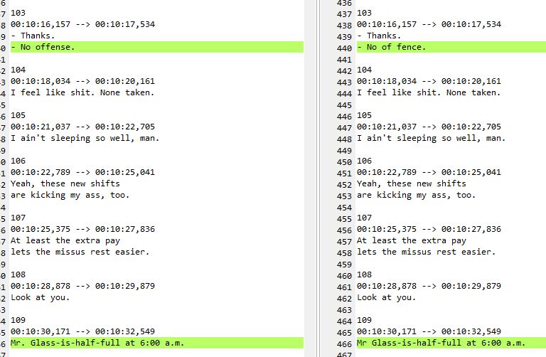

Ok, everything is the same (video, audio). The only difference is visible in the regular english subtitle. And it looks like "801" is the revised final version (801 left, 803 right):
2019-11-18 22_43_03.jpg (68.4 KiB) Viewed 9477 times

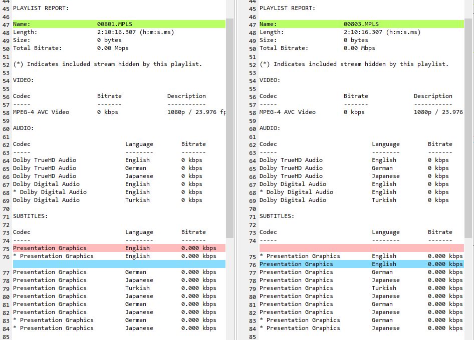

I know that. The question is how to determine the correct track as fast as possible. You suggested BDInfo. I tried it but I do not see a way to solve this task (finding out that that 801 uses a different subtitle than 803). The app does not highlight differences between tracks and does not show the filesize, track id, etc of the different subtitles or similar. Finally the only way to compare the playlists is to select the playlist in BDInfo, press "view report", copy the text into a new text file for both playlists, open both files and compare them through PSPad Editor:
2019-11-23 12_26_59.jpg (152.32 KiB) Viewed 9406 times
But then I still do not know which subtitle is different and what the differences are. I still need to rip both MKVs, extract all subtitles through gMKVExtractGUI, OCR' them with Subtitle Edit and compare the texts with PSPad Editor. And this is how I did it before. So BDInfo does not speed up this process or I did not found the relevant function in this app.
