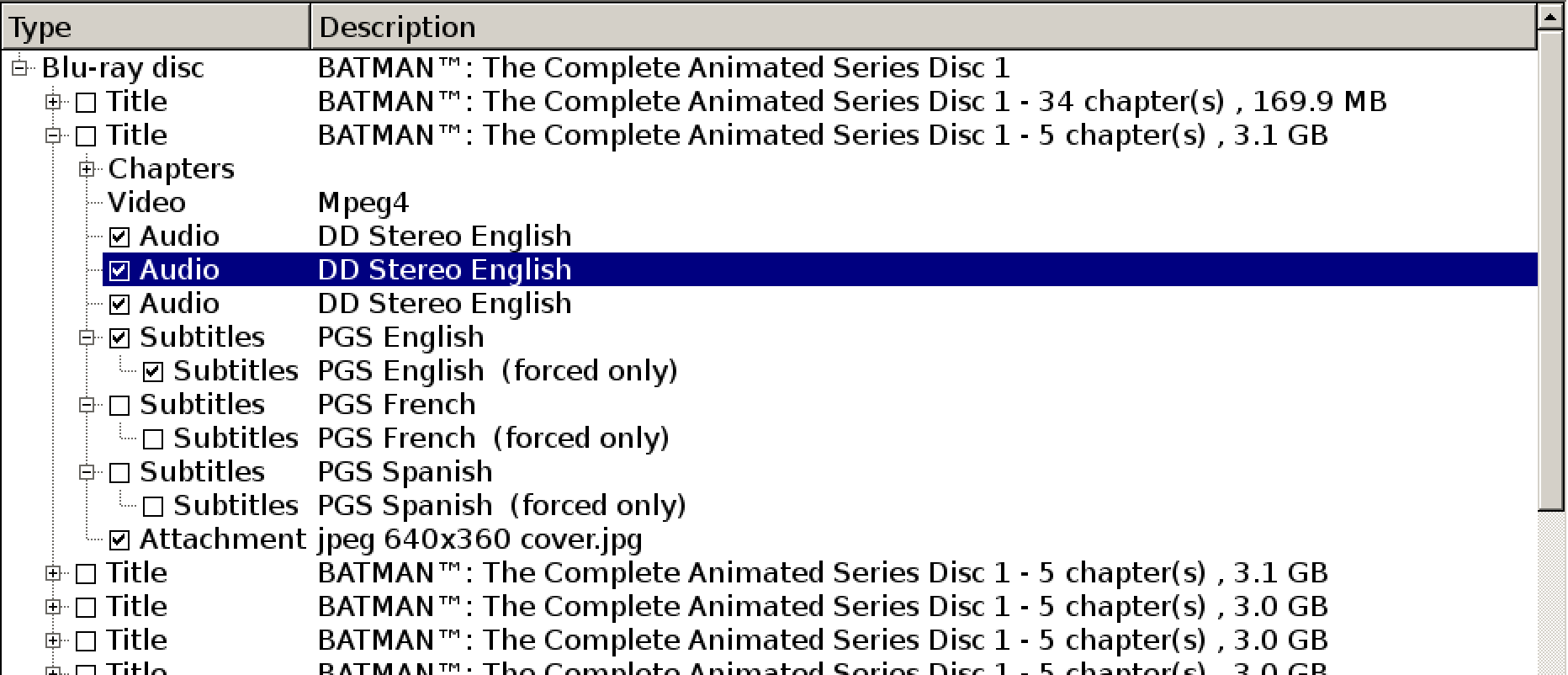

I have just ripped Batman - The Animated Series Series 1 Disc 1 Episode 1. There are three audio tracks identified on MakeMKV, and in the resulting output file. However, these are all identical, audio commentary tracks.
I have made an Unencrypted Backup and this plays normally ( episode audio, no commentary) via VLC. Again, single episode MKV extract from that backup behaves exactly the same as direct from disc ( 3 identical, audio commentary tracks).

Thanks for your reply! Yes; I expanded the contents fully and there were three tracks, and all selected. I tried to see if there was any discernible different in the info box but there was not.
Would a screenshot help at all? I’ve ripped thousands of discs and never came across this before!

None; only English??!! Screenshot attached...
UPDATE: Added Media info screenshot from VLC during playing the Unencrypted Backup...

SOLVED!
So I went and checked the other titles... guess what? 3 languages all shown correctly. The first track seems to be duplicate with only directors commentary. I feel slightly stupid but glad its sorted!

That's was my next question. Simply duplicates with other MPLS are on many Blu-rays. F.e. only Japan language tracks are in an extra MPLS. Can be identified very fast by checking the title MPLS Segment Map in the below right MakeMKV window. If the stream segments are the same, the video streams(s) is the same and only the included tracks (audio and/or subtitles) are different.
