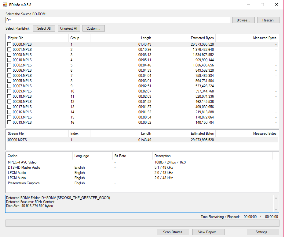

Power DVD reports a length of 01:43
BDInfo reports 01:43:49

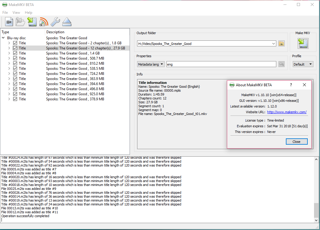

MakeMKV reports 01:45:59

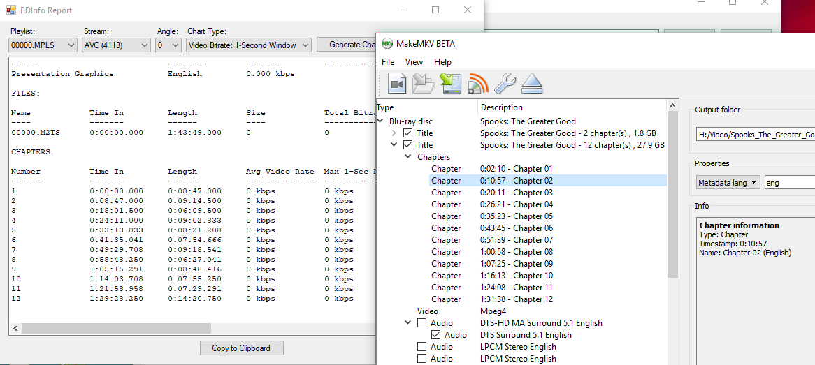

What's odd, is all the chapters seem off by 02:10, which is when that Test card etc ends, and the film begins.

That is certainly strange and "other sources" confirm that the BDInfo info should be correct.
Personally I don't recall a similar problem like this one, where there is a discrepancy like this, and also MakeMKV only reports the one segment.
Unless someone else here has ideas, this might be a case that requires submitting a test dump to Mike so that he can look into this in more detail:
/onlinehelp/testdump.html
