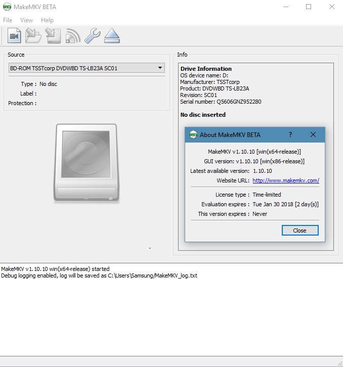

Hi, new here.
I recently updated to the latest version of MakeMKV and none of my Blu-Rays will load now. The disc spins but then says no disc. DVD's work perfectly, but for some reasons BDs aren't even showing up on Windows 10 explorer. Is this an AACS issue? That highest version mine has encountered up until I updated it was v61 from the film," Don't Breathe". The last movie I ripped was "Jurassic Park" a few weeks ago and it worked fine, but when I tried to rip, Harry Potter and The Sorcerer's Stone after updating, it would not read and seemingly locked up. Do I just need to wait for an update or is something else at play? :?:

It says the version I have is 1.10.10, the most up-to-date.

Changing the date still did not resolve the problem. I generated a log and here were the contents.
Debug log started at Sun Jan 28 18:12:48 2018 , written by MakeMKV v1.10.10 win(x64-release)
Using 524544KB for read cache.
001005:0000 MakeMKV v1.10.10 win(x64-release) started
001004:0000 Debug logging enabled, log will be saved as C:\Users\Samsung/MakeMKV_log.txt
Application exited at Sun Jan 28 18:14:05 2018

I did load a disc, it never loaded in either Windows or MakeMKV. It makes noise like it's gonna read it then stops and says no disc. Is there something I can do with Windows to keep it from interfering? I've cleaned both the drive and disc multiple times and even tried multiple discs to no avail. I can try some more and see if any load.
