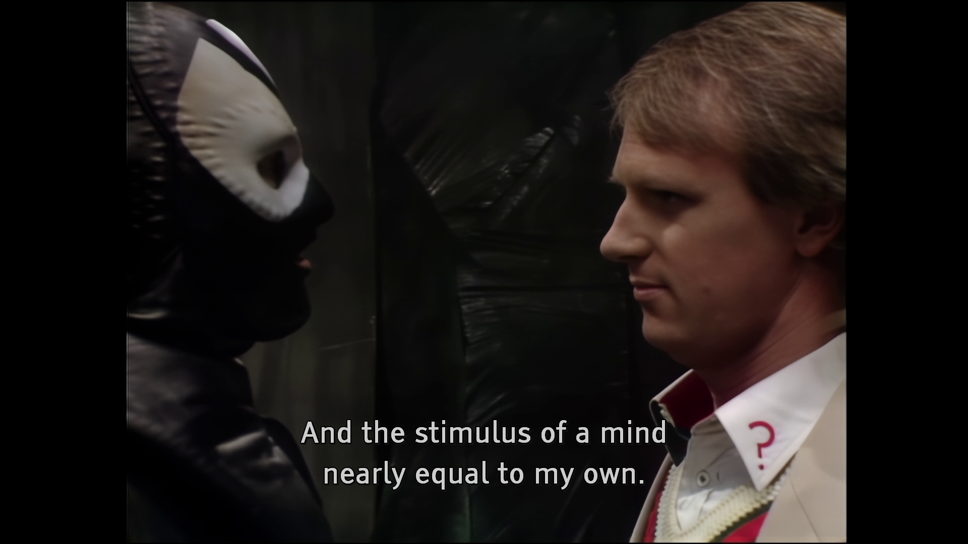

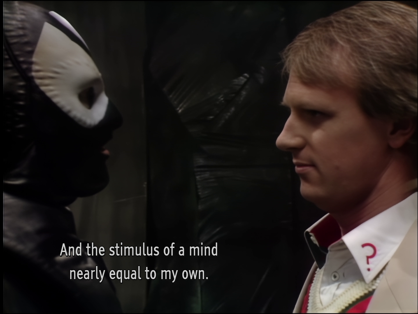

The player I use is VLC. I've just checked with the window larger than I normally have it. It does remove the bars when I set it to 4:3, but it also squeezes the subtitles way thinner and off-centre, even though they're specifically designed to only occupy the same space as the actual image, as you can see:
Those are exactly the same paused frame; all I did between those two screenshots was undo the cropping.
