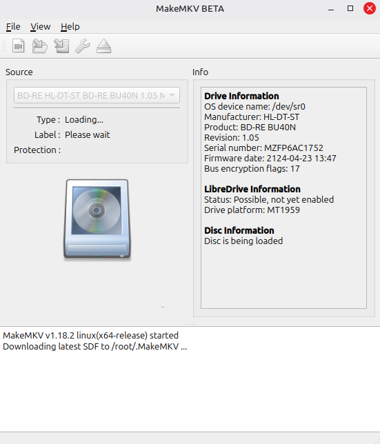

The software keeps showing "Loading disk" on the screen but doesn't do anything else. It's stuck at this point.

So, how can I narrow this down? I don't get any debug information besides the above mentioned, no errors either in the debug log or ring buffer or anywhere else...

Re: USB Drive with Blu-ray disk stuck on "Disk is being loaded"
You need to flash your drive to enable Libredrive support.
viewtopic.php?f=16&t=19634
Have you applied the beta key for Makemkv?
viewtopic.php?f=5&t=1053
