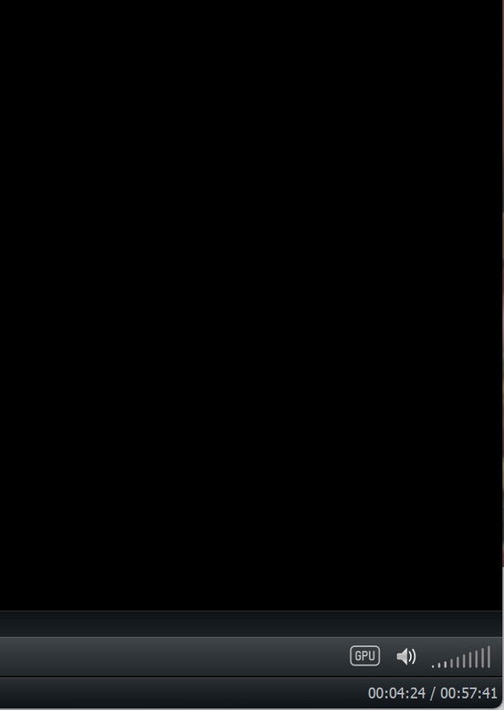

For example, in the MKV you watch normally, then at 4 minutes and 8 seconds it ends, and then we have a full 1 minute (!) of black screen with no sound.
At 5m08s we see the extra feature again, image and sound. If I were to guess, this "fade out" is when the bonus content goes to a commercial. Fade in is when it resumes.

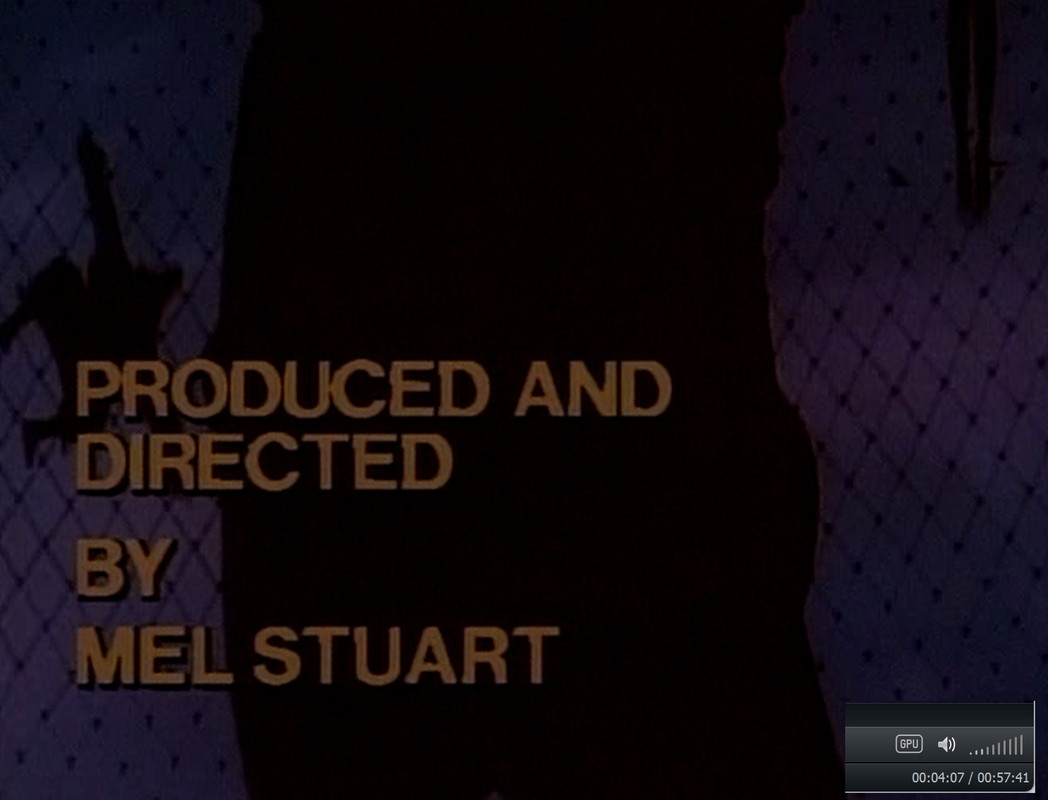

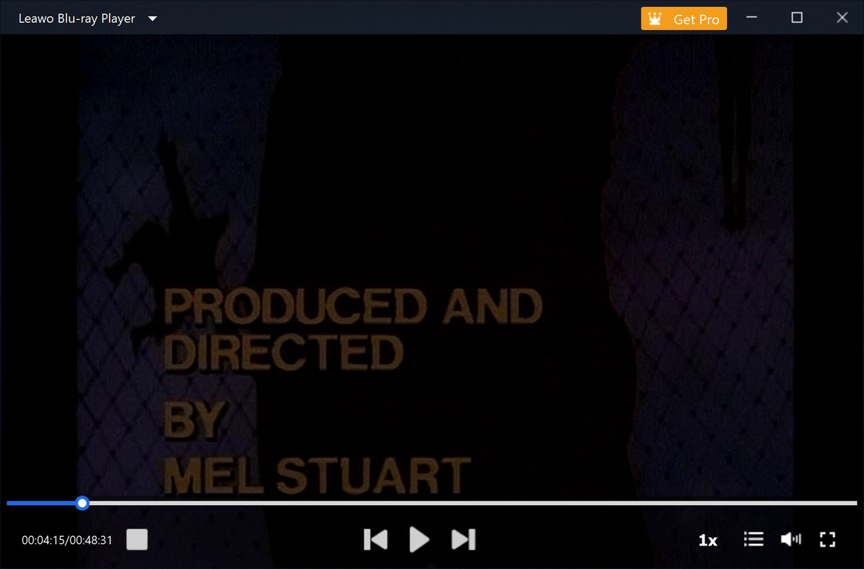

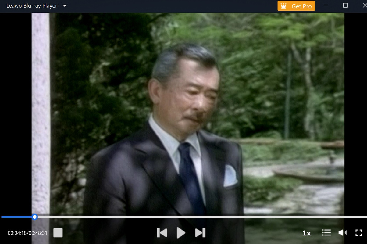

A few screenshots:
LEAWO:
At 4m18s we see this bit of the documentary ends (fade out).
1 second later... FADE IN. Resuming...
What we got with MAKEMKV after I appended the splitted files:

The 3rd image show the fade in (resuming) starts at 5m09s. Not at 4m18s where it was supposed to happen. 1 full minute of black screen was added by MAKEMKV. This happens again during those 57 minutes.
