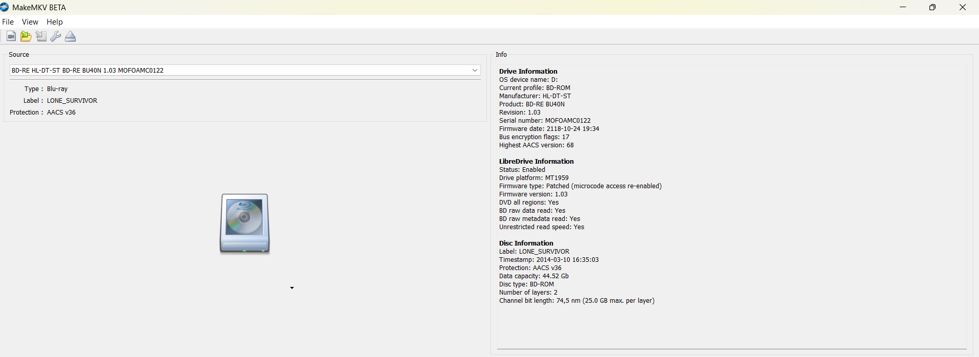

I have a brand-new Verbatim External Slimline KJAB 43888 BU40N and have flashed the firmware 1.03 to enable LibreDrive as per the instructions on this site. I have tried both the USB-A to USB-C cable that came with the drive and also tried a USB-C to USB-C cable that has worked on other rips but not this one.

Please see attached screen shots.

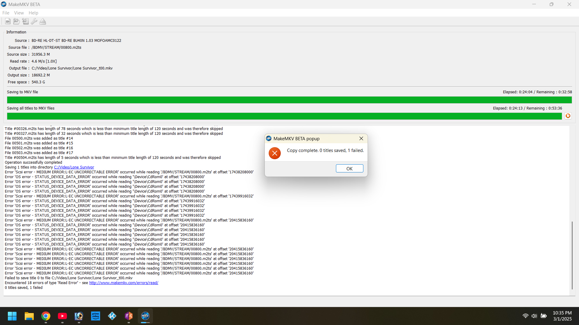

Errors like that generally indicate that the drive is unable to correctly read a spot on the disc. The standard advice is to gently clean the disc and try again. I know you cleaned the disc already, but it can't hurt to try cleaning it again.
Personally, I clean discs with plenty of warm water and liquid dish soap. I like to dry them with a can of air.

I did clean the disc again as you suggested but it kept failing to read at just over halfway through the main title. I tried to use MakeMVK to do a backup but it again failed. Finally, I tried copying the .mt2s file of the main title directly from the Blu-ray disc to my hard drive and it failed at about the same spot. So it's not MakeMKV.
On closer inspection, there is a very faint visible ring near the outer edge of the Blu-Ray disc. It's difficult to see unless I put it in direct light. It looks as though the disc was either scratched inside a Blu-Ray drive or that it was some kind of production/manufacturing error. It's hard to see how it would have been scratched by mishandling. There doesn't seem to be any depth to it that I can feel.
Anyway, I guess I'll just have to do with the DVD version that came with the case. I bought it used for $7 at a local second-hand videogame/movie store. No refunds.
