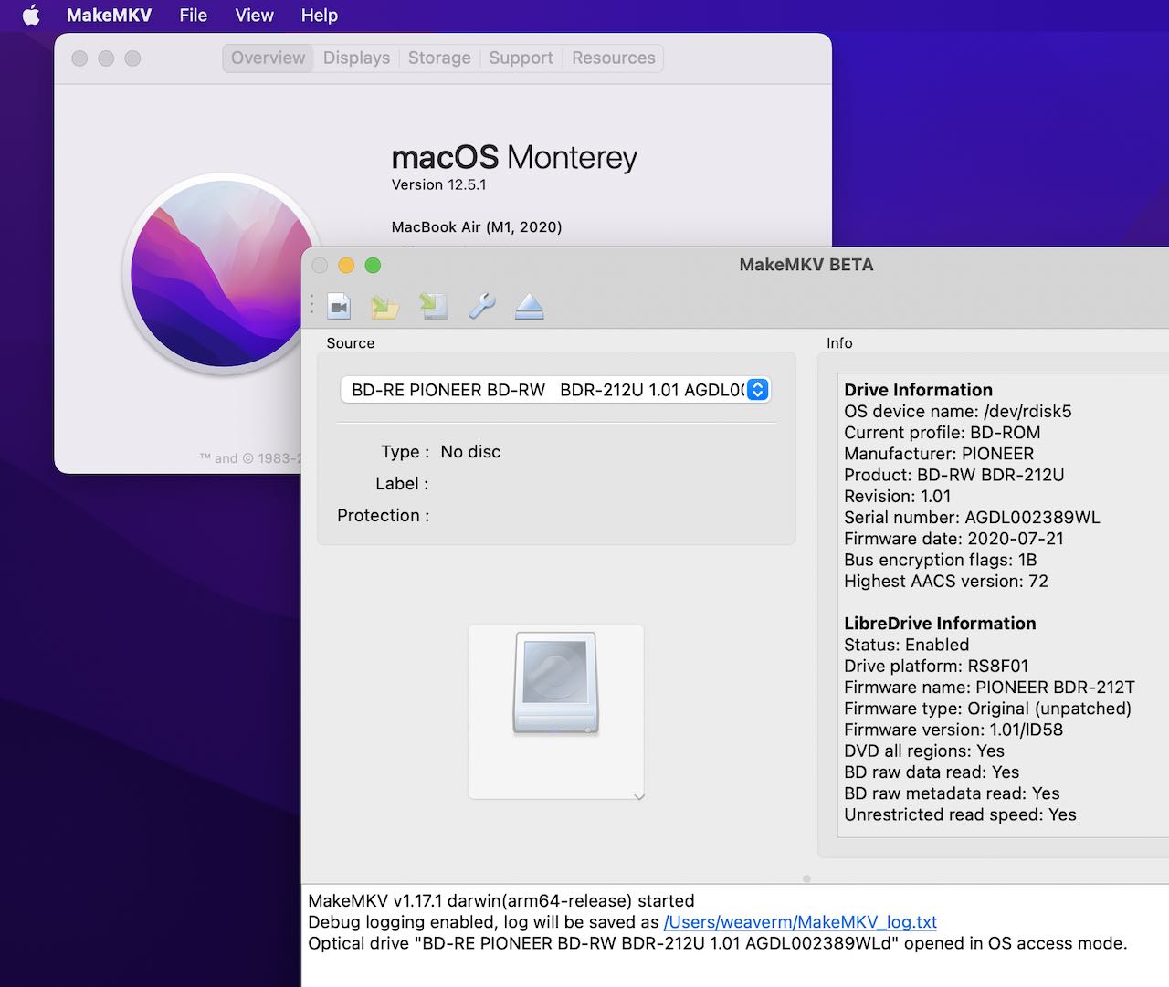

Well, I've got three of the drives on that list. I've used all three of them with MakeMKV on my M1 MacBook Air. What are you looking for in terms of support?

dcoke22 wrote:
Thu Aug 18, 2022 1:36 pm
are you on Monterey?
I am wanting to know if anyone using Monterey can recommend one. Any I have found use a lot earlier operating systems.
Posts: 3742
Re: Blu-Ray Write MAC M1
Yes. I even took the enormous amount of time Apple seems to need to install updates to install the 12.5.1 update today. My Pioneer BDR-212U is running a blu-ray backup right now.
I'm still not sure what you're looking for. On macOS, optical drives don't have any drivers or software to install. A built-in driver is used by the OS to access the drive. Are you looking to use the drive more broadly than for MakeMKV?
