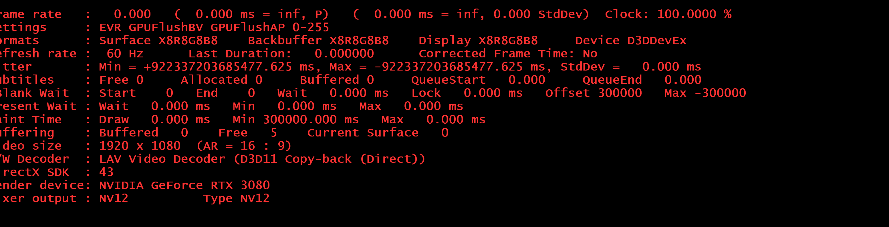

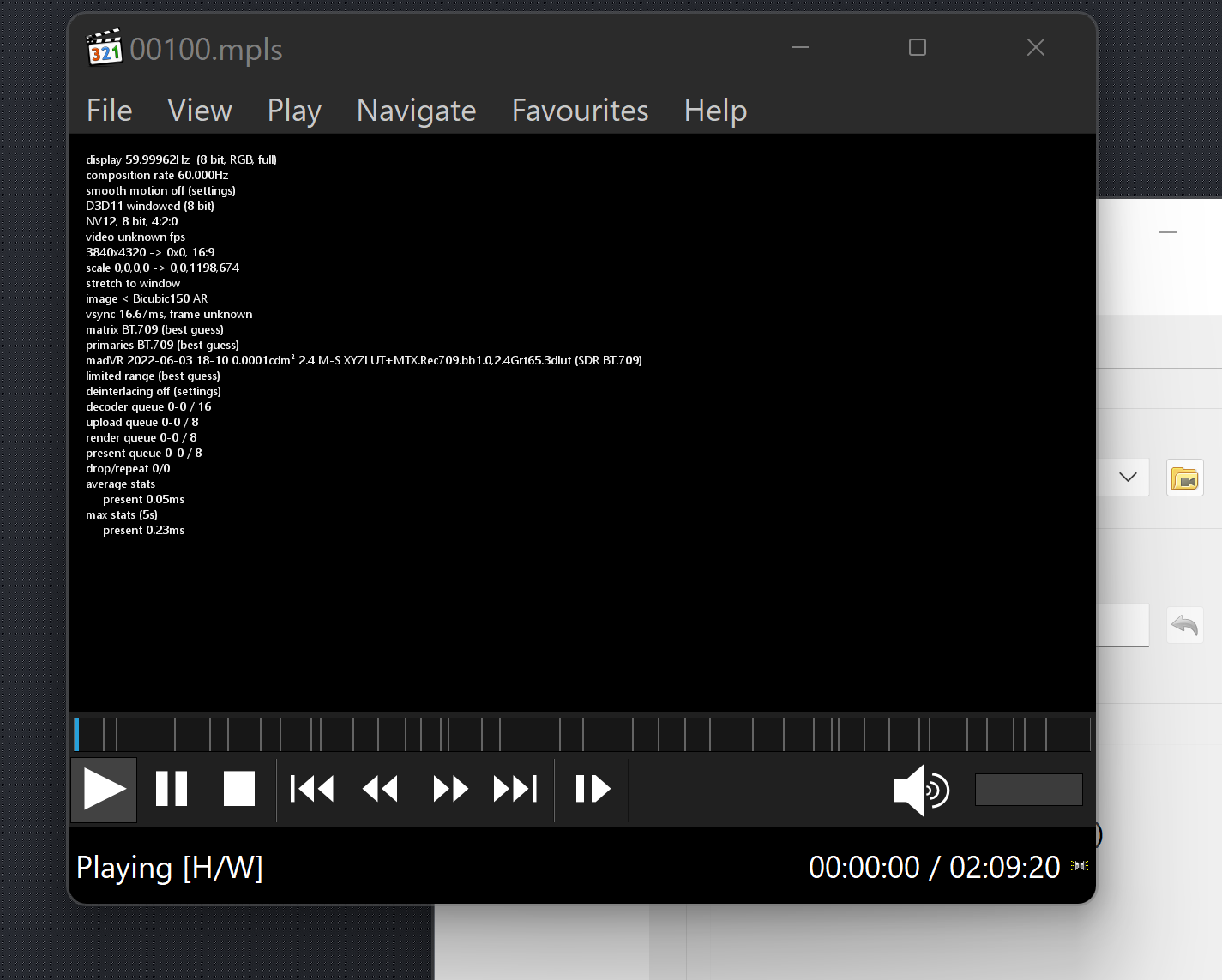

Madvr running on 0,05 0,023 ms is normal for 1080p.
Lav video decoder is ok (D3D11)

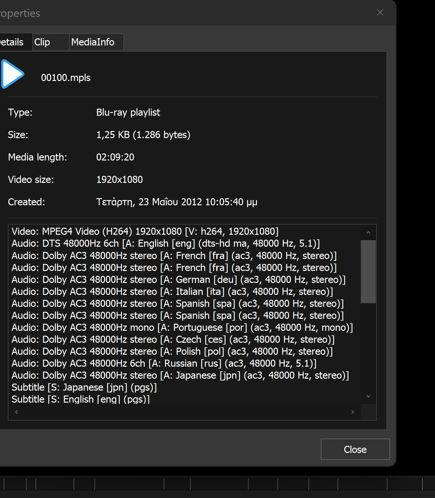

It seems that the problem is related with MAKEMKV.
MAKEMKV is reading only the playlist 1,25 kb.
