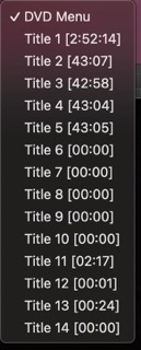

I’m now having some problems with (at least one) of my West Wing DVDs. This is S5 Disc 2 from the complete season set, not the complete series set. I tried ripping it to VIDEO_TS with MDRP. It stalled out. I tried playing Title 1 (the “all episodes” title) in VLC. It crashed the app. I cleaned the disc, restarted my computer, and tried MDRP again. No dice. Then I tried MakeMKV. It ripped two episodes (Titles 2 and 3, aka the two episodes that I never watch as opposed Titles 4 and 5, aka the two episodes I watch a LOT). The log from that session is below and I included a screenshot of the Title menu to show the durations, in case that’s useful.
Speaking of cleaning discs... I’ve ripped or converted probably 100 DVDs in the last week: Almost all of The West Wing (to VIDEO_TS with MDRP) plus a huge number of homemade DVDs (using MakeMKV first and MDRP if that failed). Every time a disc fails, I clean it and try again. At no point has that ever worked. Is cleaning a myth? Or am I doing it wrong? (Given my history of whacky tech problems, it could also just be me.)
Here’s my method:
1) Lay disc on eyeglass cleaning cloth, playable side up
2) Spray eyeglass cleaner (the legit stuff from the optician) lightly onto disc surface
3) Use 2nd eyeglass cleaning cloth to wipe across the disc in straight lines
4) Examine disc to see if there are any spots, blemishes, streaks, etc.

MakeMKV v1.17.8 darwin(arm64-release) started
Optical drive "BD-RE PIONEER BD-RW BDR-X13 1.03 CHDL000164UCd" opened in OS access mode.
Using direct disc access mode
Error 'Scsi error - MEDIUM ERROR:L-EC UNCORRECTABLE ERROR' occurred while reading 'BD-RE PIONEER BD-RW BDR-X13 1.03 CHDL000164UC' at offset '3659528192'
Title #1 (2:52:14) was skipped due to navigation error
Cells 7-7 were removed from title end
Title #2 was added (6 cell(s), 0:43:05)
Title #3 was added (6 cell(s), 0:42:55)
Cells 1-1 were removed from title start
Title #4 declared length is 0:38:07 while its real length is 0:00:00 - assuming fake title
Title #5 (0:43:05) was skipped due to navigation error
Title #11 has length of 21 seconds which is less than minimum title length of 120 seconds and was therefore skipped
Title #11/1 has length of 7 seconds which is less than minimum title length of 120 seconds and was therefore skipped
Title #11/2 has length of 78 seconds which is less than minimum title length of 120 seconds and was therefore skipped
Title #11/3 has length of 29 seconds which is less than minimum title length of 120 seconds and was therefore skipped
Title #12 has length of 1 seconds which is less than minimum title length of 120 seconds and was therefore skipped
Title #13 has length of 12 seconds which is less than minimum title length of 120 seconds and was therefore skipped
Title #13/1 has length of 12 seconds which is less than minimum title length of 120 seconds and was therefore skipped
Saving 2 titles into directory /Volumes/Disc Library/West Wing DVD/West Wing S5D2 MKV
2 titles saved
