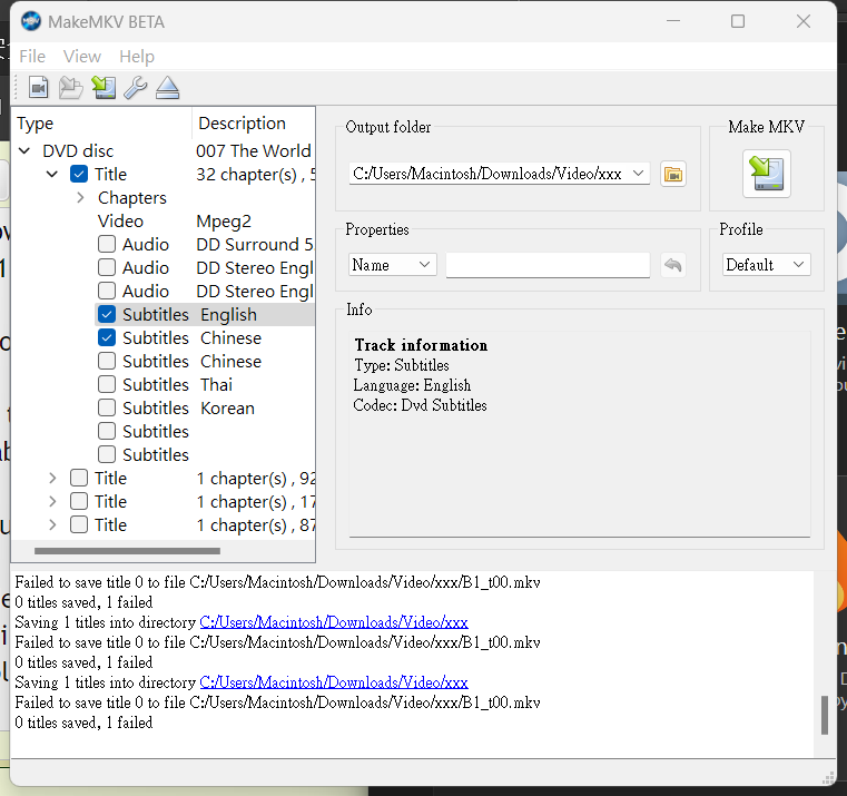

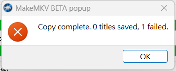

I do not know why The 007-The World is Not Enough Region 3 DVD is always failed to be extracted by MakeMKV V1.1.73.
How can i contact with the author of MakeMKV?
I have tried to extract The DVD content from the discs that comes from three different source. None of them is able to be extracted successfully.
it is never successful even i purchased a brand new disc to extract it.
i can provide the error message and screenshot.
i hope that i can get the answer and i would like to provide everything the author needs in order to fix the problem.
anything else needed about the disc can also be provided by me. all you need is to leave me a message here and tell me what you need.

- 圖片_20230216223038.png (9.11 KiB) Viewed 7164 times
- 圖片_20230216223047.png (56.26 KiB) Viewed 7164 times

Open the Preferences page and turn on extended debug messages. Something is happening that isn't being reported under the short debug code.

and i found something interesting...
the issue will be fixed if i choose not to extract english subtitle.
i also tried to extract the subtitle with VobSub.
the english subtitle is able to be extracted by VobSub, nothing is wrong, it works perfectly.

Re: hi ... The 007 The World is Not Enough DVD Region 3
Leaving out a track (in this case a subtitle) would remove checks for timing on that track, so the overall rip would not fail. Why it is failing on that subtitle is a question. It seems to be failing because the time to display the subtitle is wrong.
Extracting JUST the subtitle may be ignoring the timing. That's something that I can't tell from what we've got. Perhaps the author Mike can pull the information from the debug information.
Theory says it could be cleaned up with a disk cleaning. There are a number of drives that can read stuff with errors but not report them. Often they're not nice about it - the file will fail a static check for content. Your case of being able to remove one track from a title is actually a bit rare.
