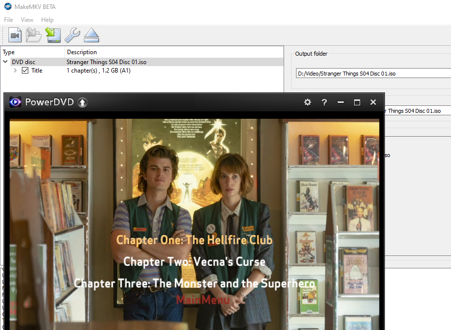

Hi guys
Stranger Things Season 4 DVD (4 Disc) are proving to be difficult.
I've got an issue with Disc 1 showing only 1 title when it's supposed to have 3.
They are all about an hour each but only the first one is found.
Is there anything I can do to make it find the rest of the titles?
Many thanks

Starting from version 1.17.0 MakeMKV has a new DVD processing engine... & there are more than a few reports of random problems. IIRC, selecting 'CellTrim" solved the problem for others w/ problem discs. YMMV
DVD opening modes - CellWalk, CellTrim, CellFull
If that bears no fruit, try Manual Mode.

Thanks d00zah
I cancelled which forced it over to the CellTrim method and it showed the full length (weird DVD has all 3 episodes as a single video, I think they just bookmarked the 3 hr long video as 3 chapter selections for each of the 3 episodes or something).
I don't know if this is related but I'm hitting constant issues with ripping and they all seem to stop towards the end (different times). Anything in the log that would help to identify the issue? Although the disc is clean (and new) I've given a good clean as that's about my level :P

I'm trying to work out if it's one of these reasons
1. Some advanced copy protection
2. The DVD disc has a fault (no physical damage can be seen)
- I've ruled out drive issues (kind of) as I've tried this with both a drive bought through the group and my old faithful backup drive.
Any help appreciated, thanks.

Where did you get these DVDs? They are obviously homemade and maybe they have an authoring problem. The Stranger Things Season 4 was never released on disc of any kind yet.

Hmm I don't know what those are, but they are not official. Netflix never released any Stranger Things discs past season 2 in the US either. Good luck.

Check if the discs have any sort of copy protection with MakeMKV. Some legitimate 'made-on-demand' discs may lack conventional copy protection, but DVDs will generally be protected by CSS and Blu-rays by AACS.
Dal1980 wrote:
Wed Nov 02, 2022 7:13 pm
The box and the artwork maybe super easy although I'm not sure how they would have got the artwork if it's not been released... leaked I guess.
Whatever box and artwork came with the disc was most likely home-made or fan art. When there is no genuine product to compare against, pirates can slap together a design or repurpose an earlier official design pretty easily. There is no need for a leak. The same can be said of the DVD menus in your screenshot. In the future, I find it useful to check the barcodes (or UPC/EAN) of items to check whether they might be legitimate. The UPC and EAN in the listing you linked to do not show up on a quick Google search. But other (presumably legitimate) items on that site do have the correct UPC.
I've been in touch with them since my last msg and they are going to send me replacements anyhow, hopefully better luck with them when they arrive.
Sorry to say, but I think your replacements will have the same issue of most likely being home-made bootlegs.

As it happens, they sent out disc 1 and that ripped no problem first time so definitely a problem with the original disc.
I haven't had time to put all of this together but I think I might now have a complete S4 boxset to watch.
