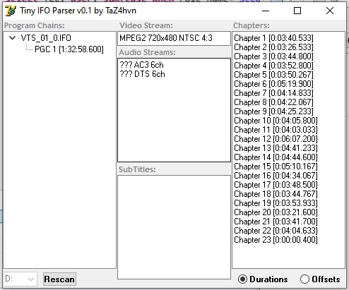

A very old IFO parsing tool I have shows this information for the DVD when it parses the IFO files, so they do not seem to be completely impassable.
BigCountry-TIP IFO parser.jpg (68.4 KiB) Viewed 4679 times
