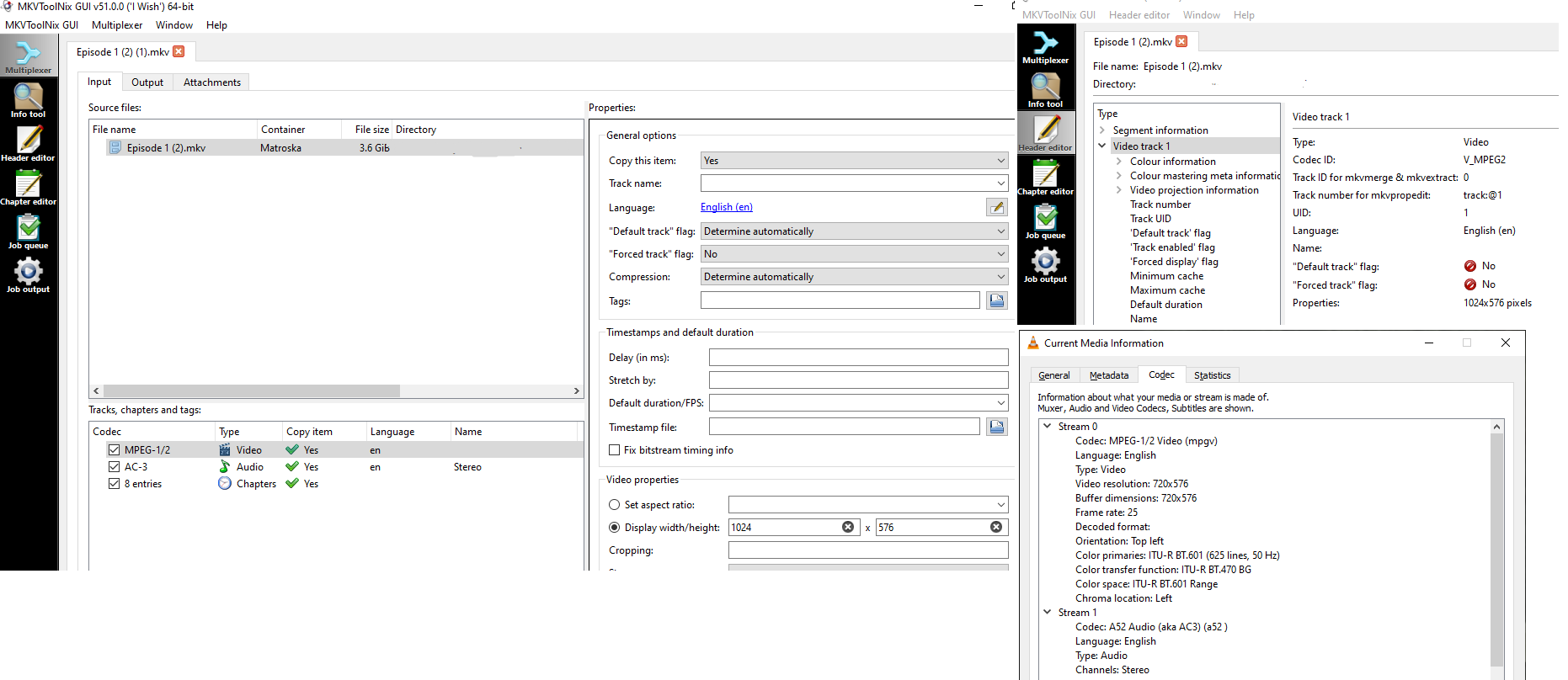

1 ) I've tried remuxxing through MKVToolNix GUI first by setting the correct display width, and then editing the headers, following this post with no luck (despite showing in MKVToolNix as 1024x576, the domensions still read at 720x576 in anything else. The attached window grabs are all the same file) https://www.makemkv.com/forum/viewtopic ... =7&t=20505

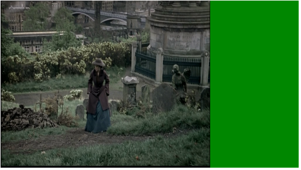

For both of these I end up with a strange green artefact - it seems to have added this onto the edge of the 'squashed' 720 image
post gMKVExtractGUI2.png (779.89 KiB) Viewed 10829 times
