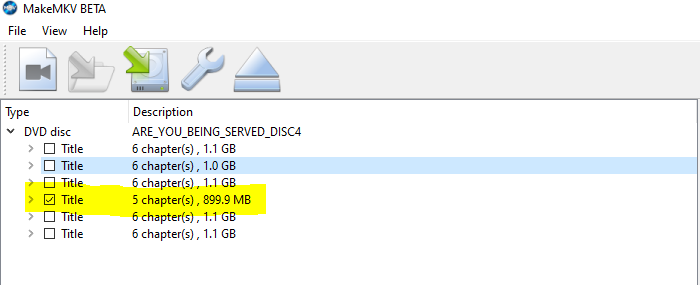

Hey Guys! As the title states, I'm trying to rip my "Are you being served" collection. (no jokes please :P ) The whole collection has ripped flawlessly except disc 4 and it rips 5 of the 6 episodes just fine but for some reason I cannot get it to rip all of them. At first I thought, maybe it's just an old disc with some scratches so I tried fixing them and then re-running the conversion but that didn't work. Next I decided to just buy a brand new disc, pulled it straight out of the plastic, inspected the mirror finish on the bottom and started the conversion on it. Low and behold it failed on the same episode with the same error and recommended that I rip it manually but i am not super experienced in manual authoring so I figured id turn to you guys for support. I attempted to rip the single episode by itself and have copied the error and verbose log below, I would love some help. I also scanned through the forum for this question and didn't see much on what I'm asking, so if I'm asking a question that's been asked a billion times before I am sorry and feel free to flame me. :) I've also attached a screen cap showing the episodes and highlighted the one that's giving me grey ball hairs lol.

Saving 1 titles into directory I:/MKV
Error 'Scsi error - MEDIUM ERROR:L-EC UNCORRECTABLE ERROR' occurred while reading 'BD-RE PIONEER BD-RW BDR-209M 1.52' at offset '96256'
Error 'OS error - STATUS_DEVICE_DATA_ERROR' occurred while reading '\Device\CdRom0' at offset '96256'
Failed to save title 3 to file I:/MKV/title_t03.mkv
Encountered 212 errors of type 'Read Error' - see http://www.makemkv.com/errors/dvdread/
0 titles saved, 1 failed
