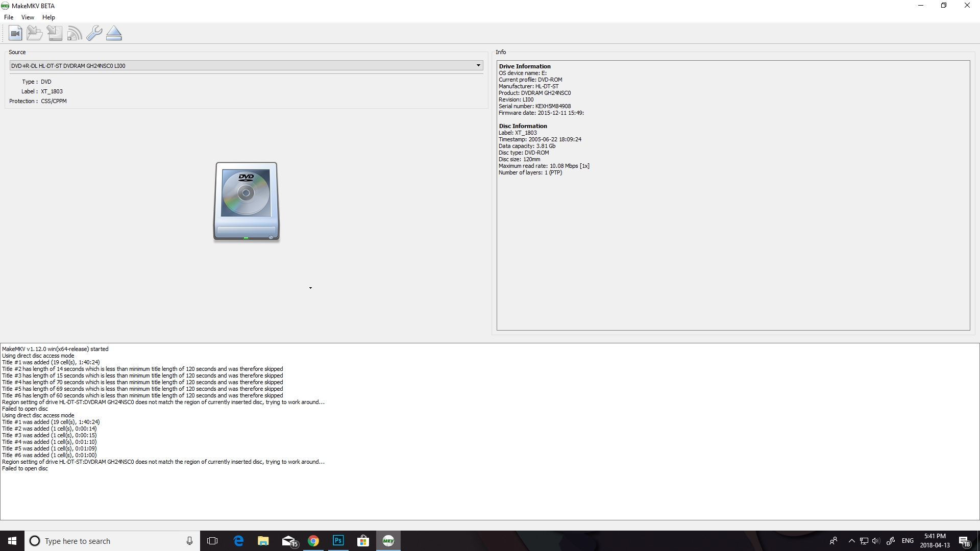

Unless MakeMKV reported "disk uses region coding that cannot be bypassed" (something like that; haven't seen it in a long time), it is not likely to be a region coding problem. I regularly open "out of region" DVDs and BDs, and you've said disks from the same set opened.
As mentioned, logs would be helpful here, so the exact error messages can be looked at. The FAQ link in my signature tells how to enable debug logging, if you don't already have it turned on.

Alright, I've been away from my computer and will be for the next few days but here is a screen capture after I tried to back up just the main feature and the entire disc; it's "Piccolino no Bouken" disc 13
