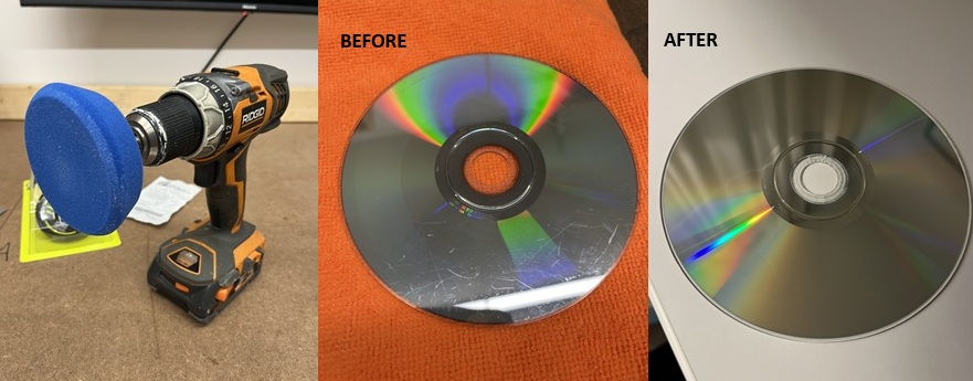

Happy to report some success with my problem DVDs. I decided to try my hand at resurfacing and so far the results are encouraging. Out of 5 discs, 2 were fixed with just one round of polishing using this $20 kit:
https://www.autozone.com/wash-mitts-cha ... 916445_0_0
The included polish feels a bit like toothpaste. You can feel the grit while spreading it. The rotary sponge worked well with my cordless drill.
For all 5 discs (all of which failed to rip previously), I started by polishing for maybe 2 minutes each, wiped it clean and tried MakeMKV again. Two discs read and ripped successfully with no errors. The other 3 discs read but still had errors during ripping.
I picked the worst of the 3 discs and used 2000 grit wet sanding paper with water. I spent no more than five minutes sanding in circular motions, then switched to 2500 for another five minutes. This resulted in plastic that showed almost zero of the original scratches but was now uniformly cloudy. I then polished again for 1-2 minutes and wiped it clean. The result looked basically brand new to my eyes. And voila - MakeMKV read and ripped with no errors.
I plan to repeat this process on my other problem discs.

That's cool. And a worthwhile last ditch effort to save some scratched DVDs.
For posterity, it is worth noting that generally speaking, the coating on DVDs is different than on blu-rays. There's more coating on a DVD, but the coating on a blu-ray is more abrasion resistant. Things might not work exactly the same between DVDs and blu-rays if you try a sanding technique.
https://en.wikipedia.org/wiki/Blu-ray#Hard-coating_technology

dcoke22 wrote: Mon Mar 31, 2025 1:54 pm There's more coating on a DVD, but the coating on a blu-ray is more abrasion resistant. Things might not work exactly the same between DVDs and blu-rays if you try a sanding technique.
That's good to know, thanks for mentioning it and providing the link. Maybe I'll research other polish options and experiment on some thrift store discs that I don't care about.
It is cool to have a workflow that basically makes any used DVD I come across viable again, as long as it doesn't have really deep gashes.

w4lkr wrote: Mon Mar 31, 2025 12:34 pm The result looked basically brand new to my eyes. And voila - MakeMKV read and ripped with no errors.
Good work; I'm genuinely impressed by your effort and success! So far, my problem disks have been ones that were relatively inexpensive to replace via eBay, but your approach is definitely something I'll keep in mind if I run into a problem with a more expensive (e.g., OOP) disk.
