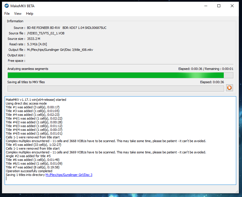

Rip fails at "Analyzing seamless segments"
Post by solidsnake1298 » Sun Aug 28, 2022 5:27 pm

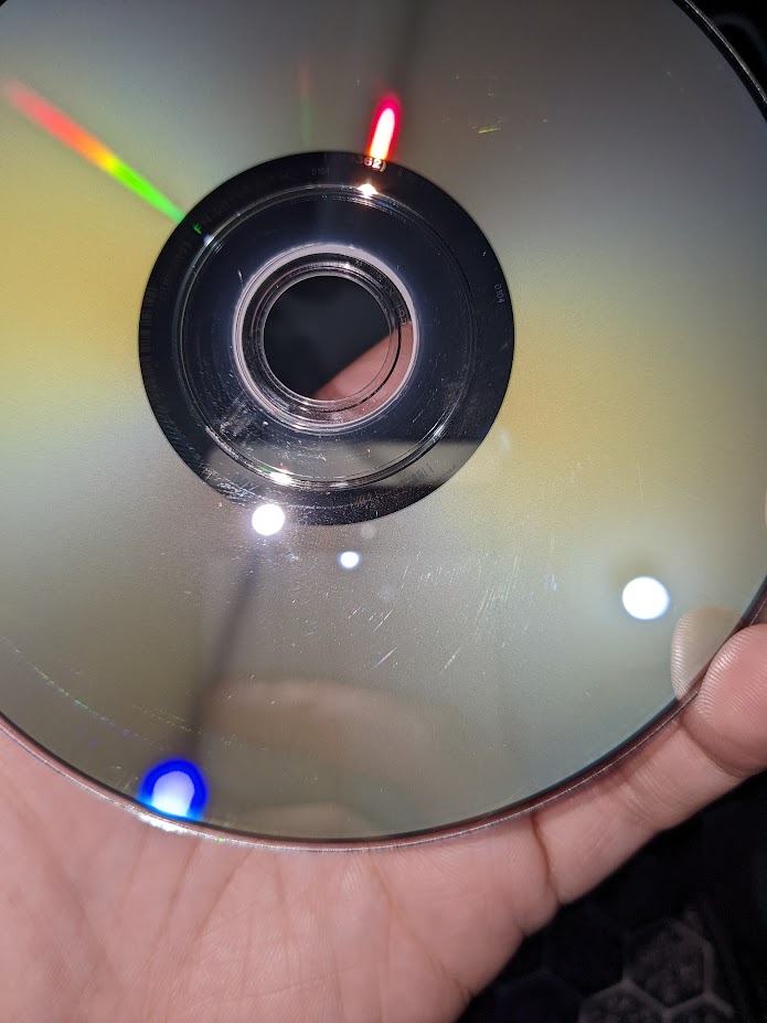

I have having trouble ripping one disc of a series. It fails "Analyzing seamless segments" after I have selected the chapters to rip. The bar will fill up to almost completing then the remaining time will increase until it ultimately fails. I've tried manually selecting different protection schemes, without improvement. I've also tried using my drive's utility to set the mode to a slower (quiet) mode. There are also what appears to be very fine scratches on the disc, but they do not affect playback.
The DVD in question is Gunslinger Girl volume 3 (Funimation 2005).

I tried making an ISO of the DVD with another utility. I mounted the ISO file and then tried again in MakeMKV, but got the same problem. It just failed more quickly when "analyzing seamless segments."

I tried following another user's suggestion, who had a similar issue, and manually set the read bugger size to something other than auto. Tried all buffer sizes, no change. This appears when I set it to debug logging.
DEBUG: Code 0 at TclZatI/;rYptTtHgv#SS:121262233
DEBUG: Code 0 at TclZatI/;rYptTtHgv#SS:121261635
DEBUG: Code 0 at nmu?x+E_4=O-+8/x]NP:213131042
