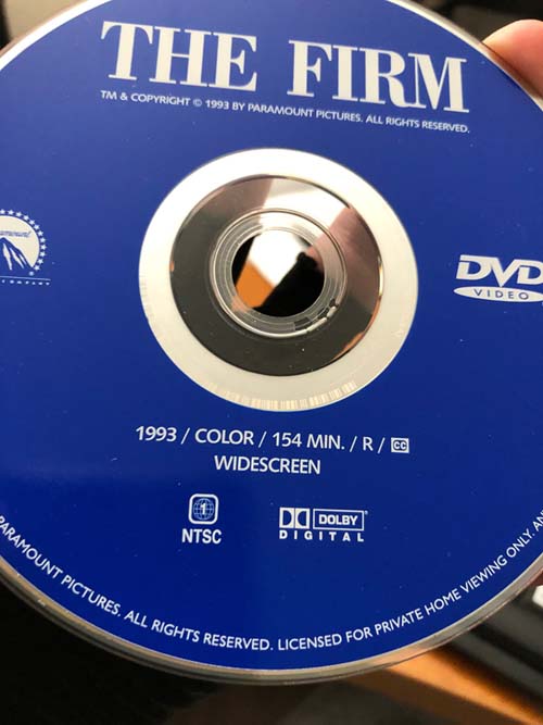

I have movie called The Firm starring Tom Cruise. It states on the box and on the disc that it is a widescreen format. I have done over 80 discs that have widescreen format and had no issues. However, the Firm disc is squishing the left/right screen into what appears as a 4:3 format. I have ripped this twice now with same results.
Does anyone know what could be wrong and a possible work around?
Thank you.
Update: Here's a couple of screenshots. One is MakeMKv info about the current .mkv file already ripped. You will see the aspect ratio as being 4:3 but the next screenshot shows to have 'widescreen' labeled on the disc.
