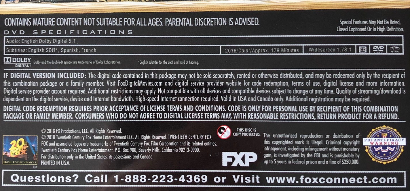

I bought a copy of Archer Season 9 and tried to rip it using MakeMKV 1.15.1 and 1.14.5. The DVD could not be opened. I checked to see if it played in my BluRay/DVD player - it opened and played normally. I tried to play the DVD in VLC 3.0.11 - it would not open. I cannot navigate to the DVD in Windows (WIN7 Pro SP1 64 bit), so cannot copy the contents. If I try to inspect the DVD contents in Windows, the DVD ejects. I tried to rip the DVD using AnyDVD HD 8.4.9.0 - the process started but aborted. I attach a copy of the MakeMKV log and a photo of the DVD cover, with details of the DVD. Any comments or suggestions welcomed. Thanks very much. pxd01
