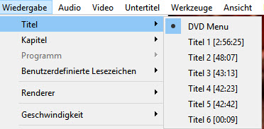

In this case, I try to rip from Smallvlle the first disc from season 1.
When I open the disc in VLC and have look to the titles, I can see there are total six titles and the menu. Please have a look to picture #1.

For me it is very important if I could use this title 1 [2:56:25], which contains all the episodes from the disk. Why? Because if I take title 2-5 I had sometimes the problem, the episodes was in the wrong order. Therefore, for me it is easier to split this one title later in four episodes as to check from every season from every TV-Show the order from the episodes.
