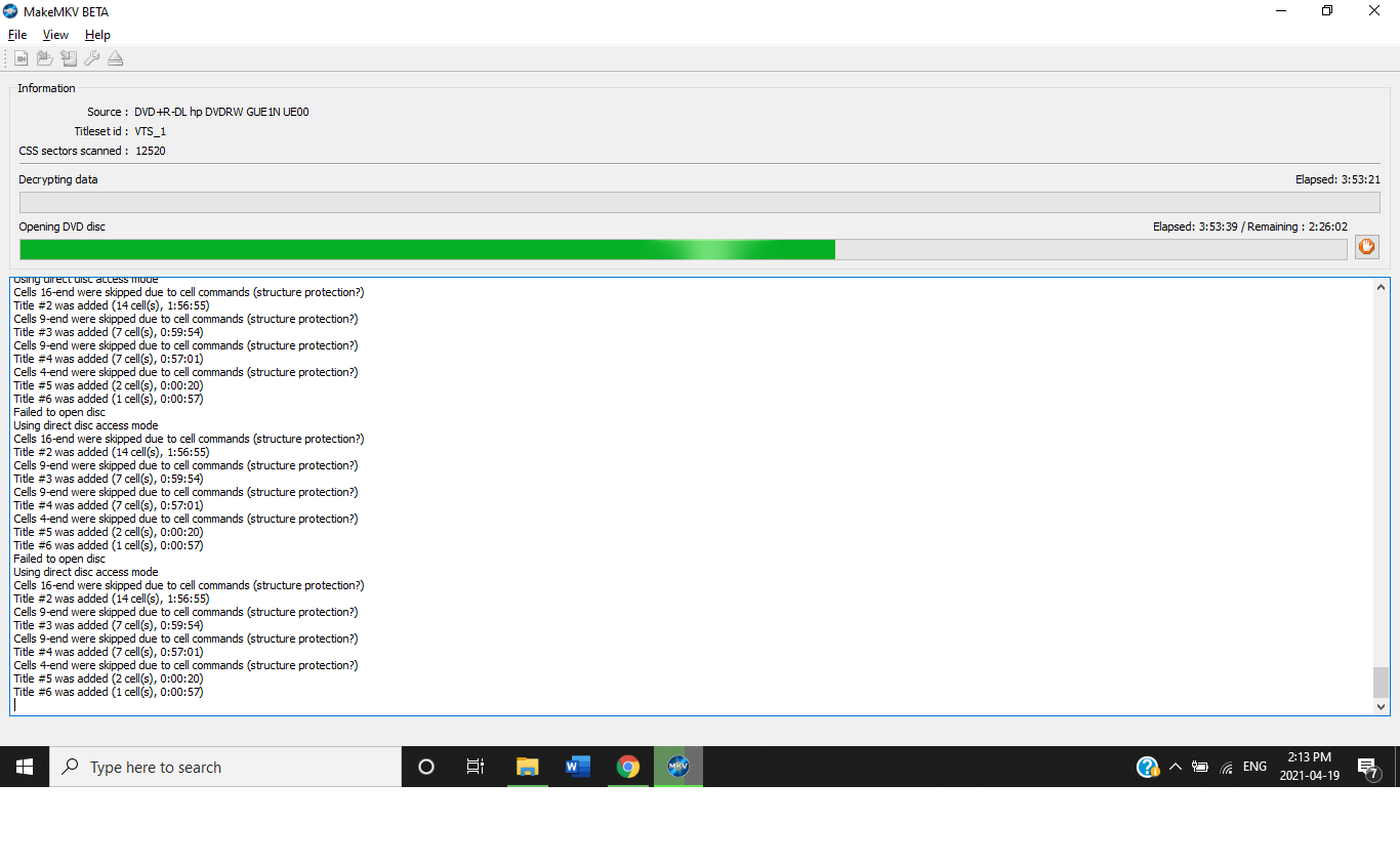

I should be more specific I suppose.
I tried both discs of Luther Season 5. Both of them get as far as to list the titles on the disc, but when it gets to the part where it scans the CSS Sectors, it gets stuck. I left it to run on the first disc assuming it would eventually hit enough CSS Sectors it would continue, however, as you can see in the attached photo, after almost four hours it had scanned through 12,520 CSS Sectors and as far as I know had no signs of finishing. I stopped the program at that point. Like the poster above, I was successful in ripping the discs to an MKV file using Handbrake, and I am able to play those files without issue. I would rather use MakeMKV though
