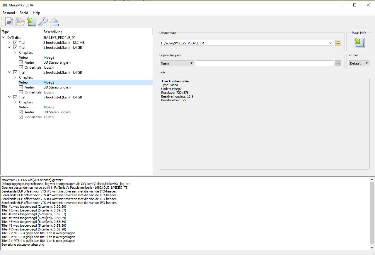

However, MakeMKV displays the wrong aspect ratio for anyone but the first episode, and generates the files with those incorrect aspect ratio's. The generated mkv of episode 1 is correctly displayed, 4:3. The following episodes are all 16:9 and don't play correctly on my PC or through Plex...

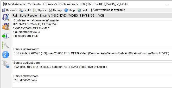

In the next image you see that the selected episode is interpreted as 16:9, while it is in fact 4:3, as the last screenshot shows.
(Note: the first episode displays the correct aspect ratio of 4:3 and results in a correct mkv file.)

The issue boils down to there being two different aspect ratios recorded for the video (one in the video itself, one in the disk's directory). They're supposed to be the same. Which should MakeMKV chose to save?
It would be better if the disk authors did it correctly in the first place...
