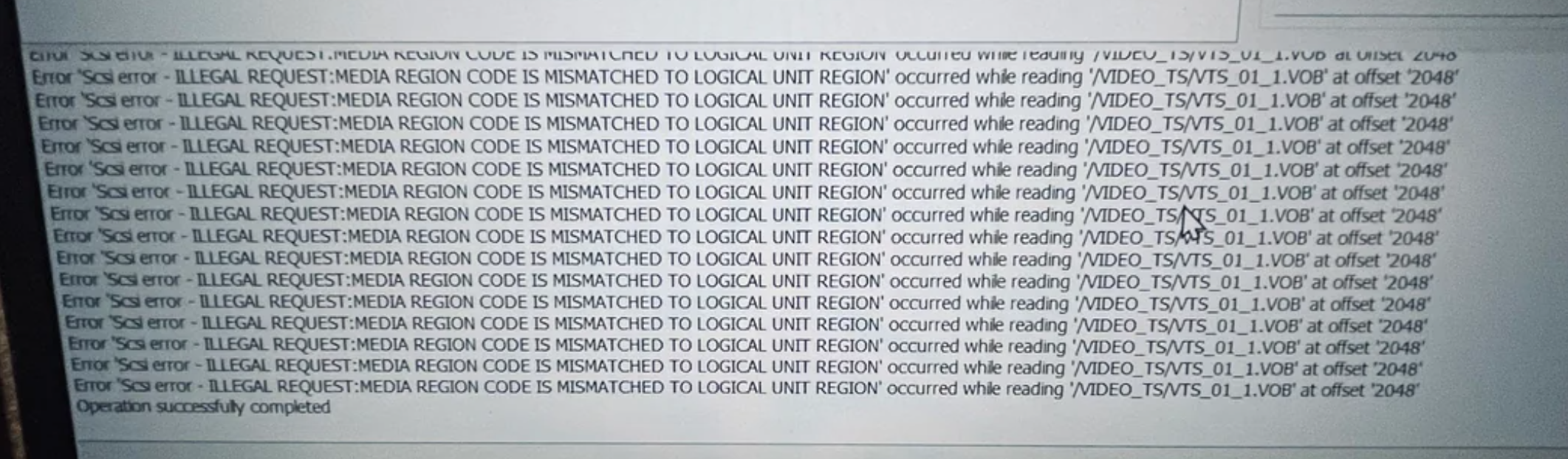

For some reason, it fails to read the DVD and keeps loading infinitely on Linux ripping machine on Docekr MakeMKV without giving any errors, So I tried to plug the drive into an Ubuntu Desktop machine it gave me a bunch of errors like:
Scsi error - ILLEGAL REQUEST:MEDIA REGION CODE IS MISMATCHED TO LOGICAL UNIT REGION

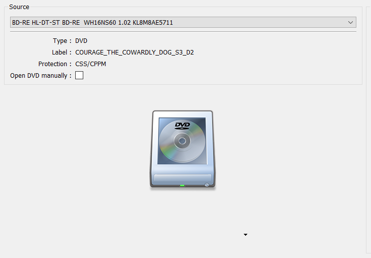

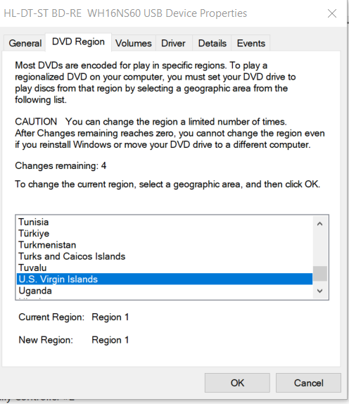

So I tried to plug it into a Windows 10 machine, and set the region to region 1 using DVD WinX and suddenly it magically started working
and MakeMKV were able to rip the DVD disks just fine.
I thought the issue was fixed but when I plugged it back into my Linux machine the problems were still happening, and still appears on Linux like it is not assigned to any region.
