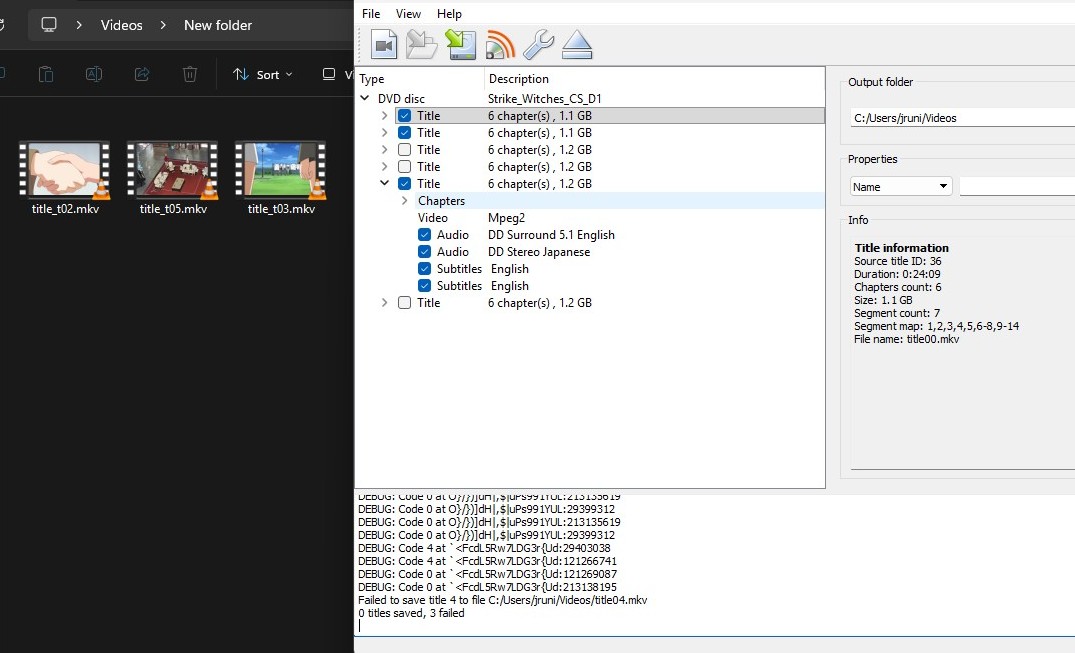

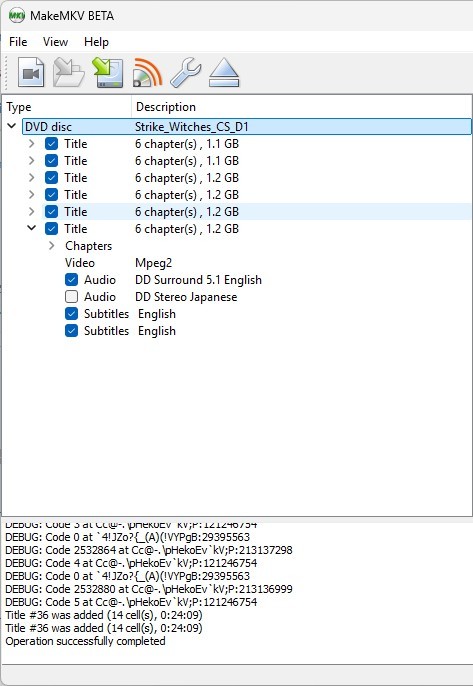

I'm trying to rip a DVD that upon opening it via the DVD disc. Ripping it only gives me 48mins of video rather than the 2 hours is in it.
This is an anime disc. So I assume the playlists is intentionally mixed. I have also tried using the "open DVD files manually" after backing up the DVD in question. I have found that backing up the ISO of the movie revealed the 2 hours of video. Pertaining to 6 episodes each about 24 mins long. Ripping this off the disc only gave me two episodes being 48 mins long.

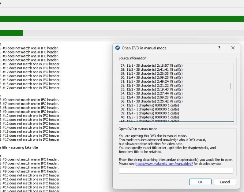

I have used the syntax for the DVD manual mode (in attempts to) rip all 6 episodes. That being cell "36" (?) Pic below:
When I put cell 36 makemkv just goes back to do nothing. Insisting(?) that the cell/playlist is "fake". Thus skipping the commands.
Does anyone know how to work around this, what I'm missing? I have also tried: CellWalk, CellTrim, CellFull and Auto none of those are able to get the entire 2 hours of episodes from the DVD.
Open DVD manually : "36"
Fake cells occupy 66% of the title - assuming fake title
Failed to open disc

#1) This was at the very begining when inputing the title and chapters. I found a list on another thread that worked for three episodes. But the other remaining three are not being ripped.

Failed to save title 0 to file C:/Users/jruni/Videos/title00.mkv

Title #36 was added (14 cell(s), 0:24:10)
Title #36 was added (14 cell(s), 0:24:09)
Title #36 was added (6 cell(s), 0:24:07)

#2) When I checked off the three episodes that worked and only ticked the rermianing three I got these new errors:
Saving 3 titles into directory C:/Users/jruni/Videos using profile 'custom' from file 'C:\Users\jruni/.MakeMKV/default.mmcp.xml'
The source file '/VIDEO_TS/VTS_13_1.VOB' is corrupt or invalid at offset 1335296-1431552, attempting to work around

Failed to save title 1 to file C:/Users/jruni/Videos/title01.mkv

0 titles saved, 3 failed
I was only able to grab three of the six episodes on the backup ISO disc. Why aren't the remianing three episodes being ripped? I suspect its because of the "fake cells" that isn't being forced. Because the entire disc plays fine on VLC/ DVD players. As well as testing the backed up ISO in HandBrake program and handbrake reads the entire 2+ hours of the disc without issue. The problem here resides within MakeMKV. The disc is not dirty and I have tried the manual mode as well as all the trim walks with no success. I have also tried to downgrade makemkv to older versions from 1.12 to the latest. The newest makemkv versions only pull three episodes out of six. And the oldest versions of makemkv pulling up all six episdoes in which I NEED. But only rips three of the six.
For reference another user was going through this here: viewtopic.php?style=6&t=28761
However it seems his problem was solved in his post? The three episodes I need are giving me the "failed to save titles 'so and so'" 0 titles saved, 3 failed" Screen. HELP?
The only other solution would be to have handbrake rip the episodes which I dont want to do because it'll become lossy instead of makemkv's loseless rip. I hope someone can fix this frustrating error.

You might try a different DVD Opening Mode to see, if the results differ.
Could be a copy protection like RipGuard
